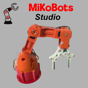

Introduction: Arduino Braccio Open Source Software MiKoBots Studio
MiKoBots Studio is an open source software that helps you to control your robot arm. It's inititlie devoloped for our own 6 axis robot arm, but is also free to use for other types of robotic arms. Like the Arduino braccio 5 axis robot arm.
