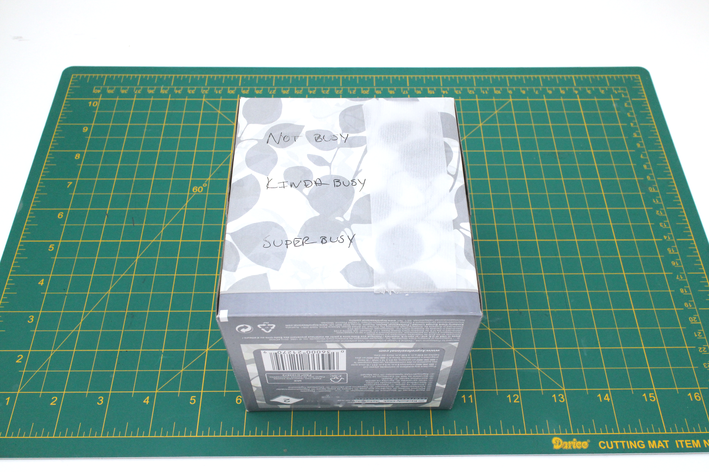

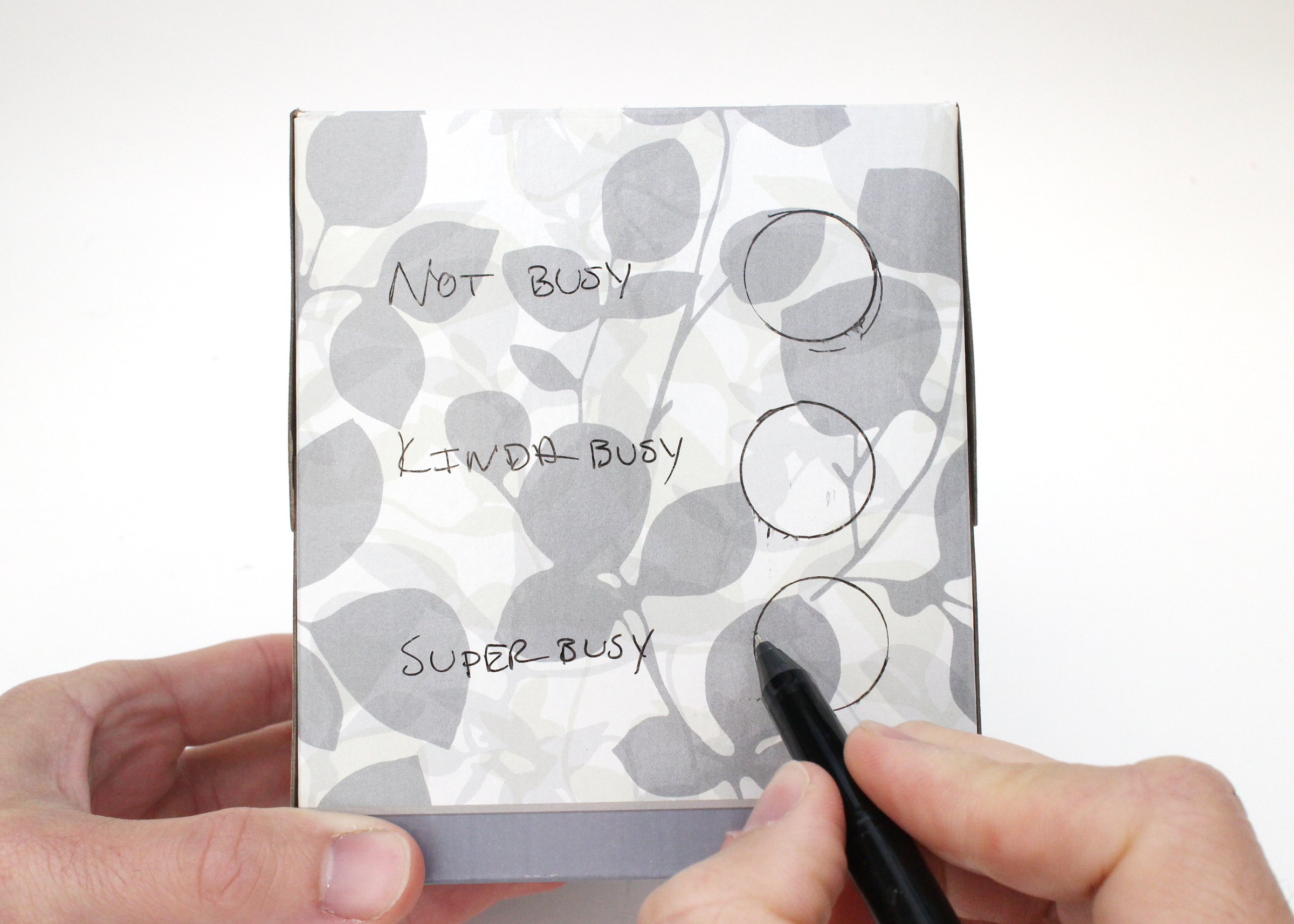

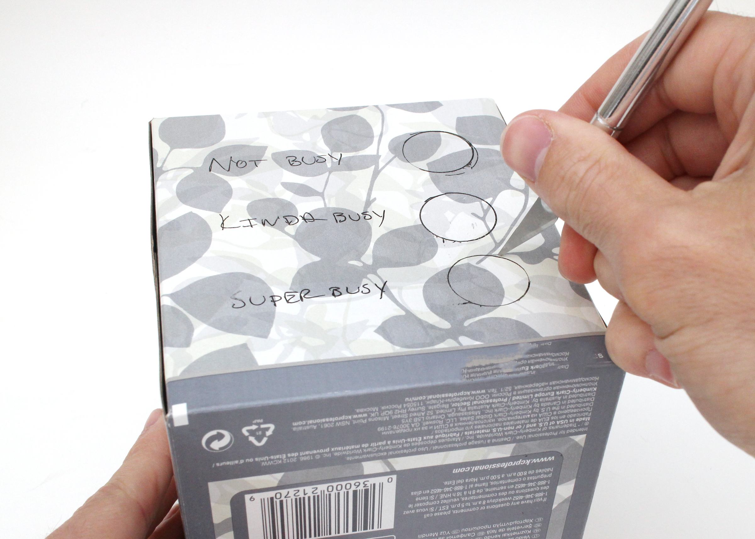

Step 2: Cutting the Cardboard
Start by drawing a line about one inch from the edge. I used the piezo buzzer we got in our kit to them make three evenly spaced circles centered on that line. These will be cut out and then replaced with transparent paper to become windows for out LED's to shine through.
Next I wrote down what I think each level of busyness should represent. Don't worry if you want to change these later we are going to spray paint the box and write the final levels in a later step.
Finally I cut out the windows with an X-Acto knife. Please be careful as these are crazy sharp.

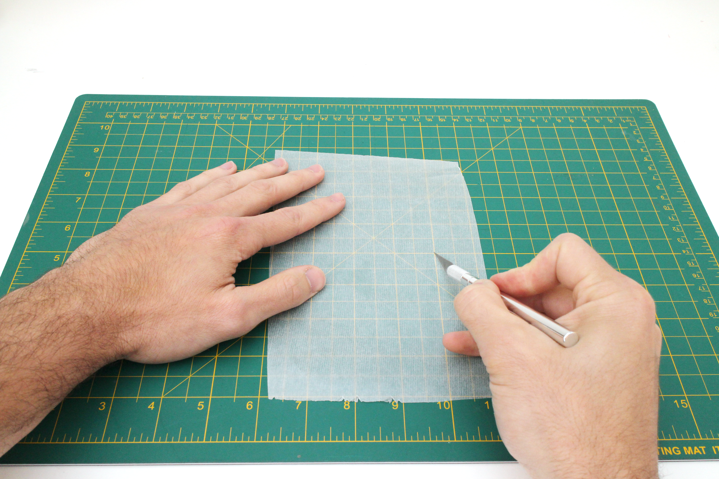

Step 3: Making the Windows
Cut a rectangle out of your diffusion paper that is slightly larger than your holes, then tape that rectangle onto the inside of your Busy-o-Meter box.

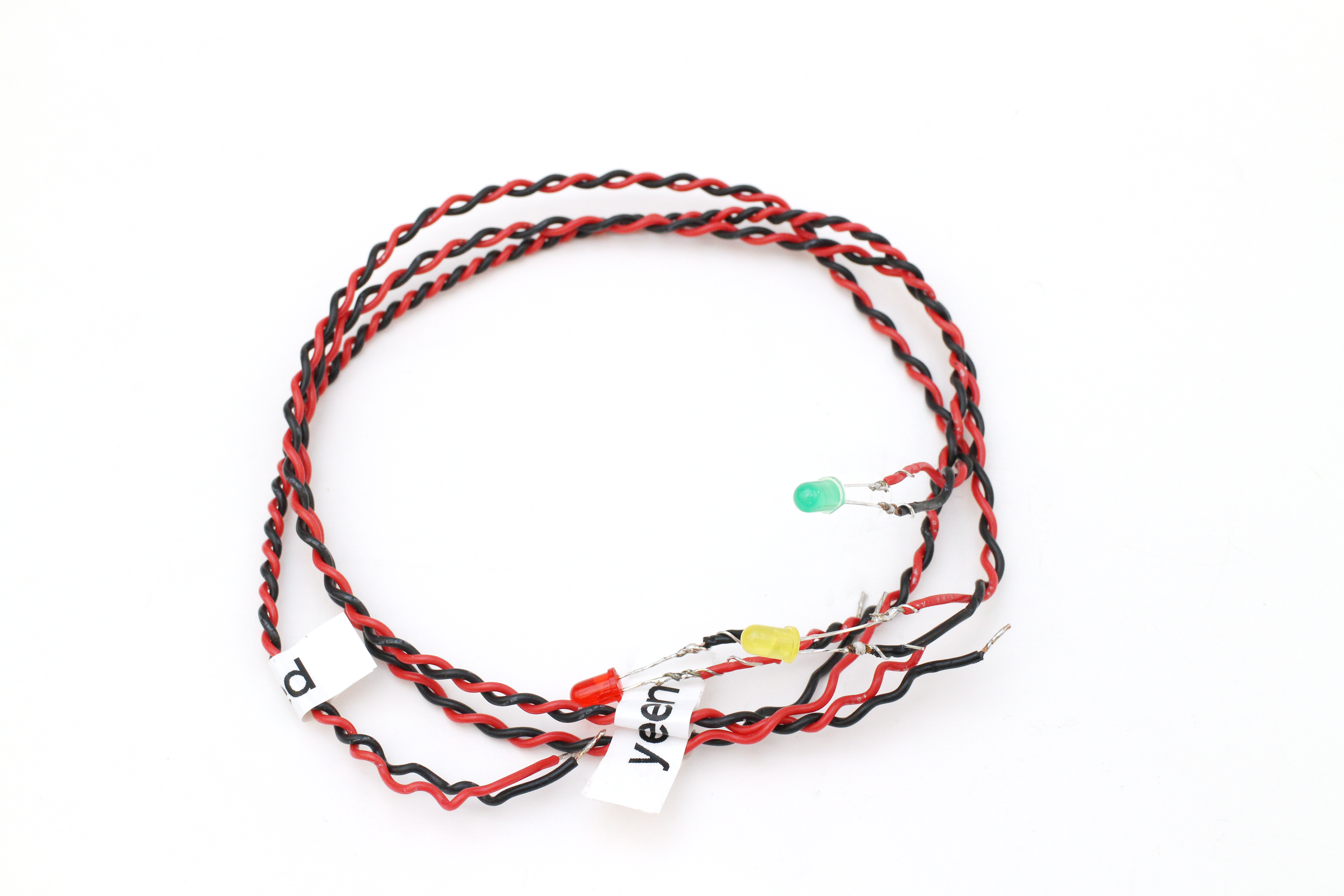

Step 5: Add Wires to LED's

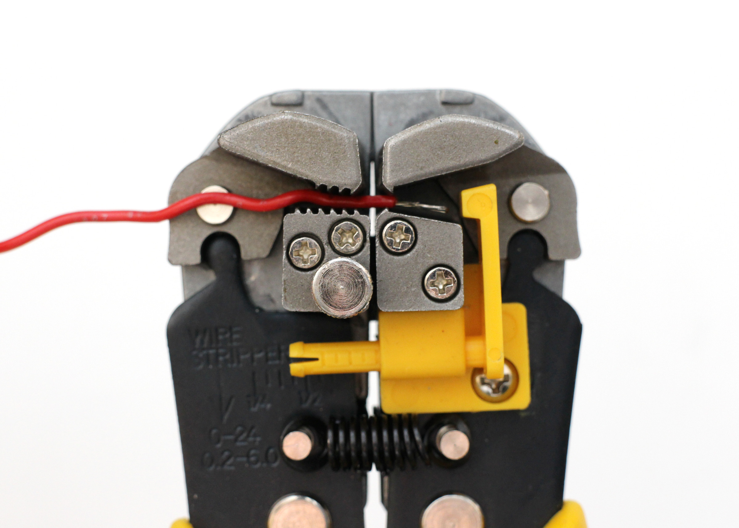

While our box could totally fit the Arduino and breadboard inside with some creative positioning. I am going to elongate the LED wires and keep the Arduino and breadboard on the outside for east reprogramming.

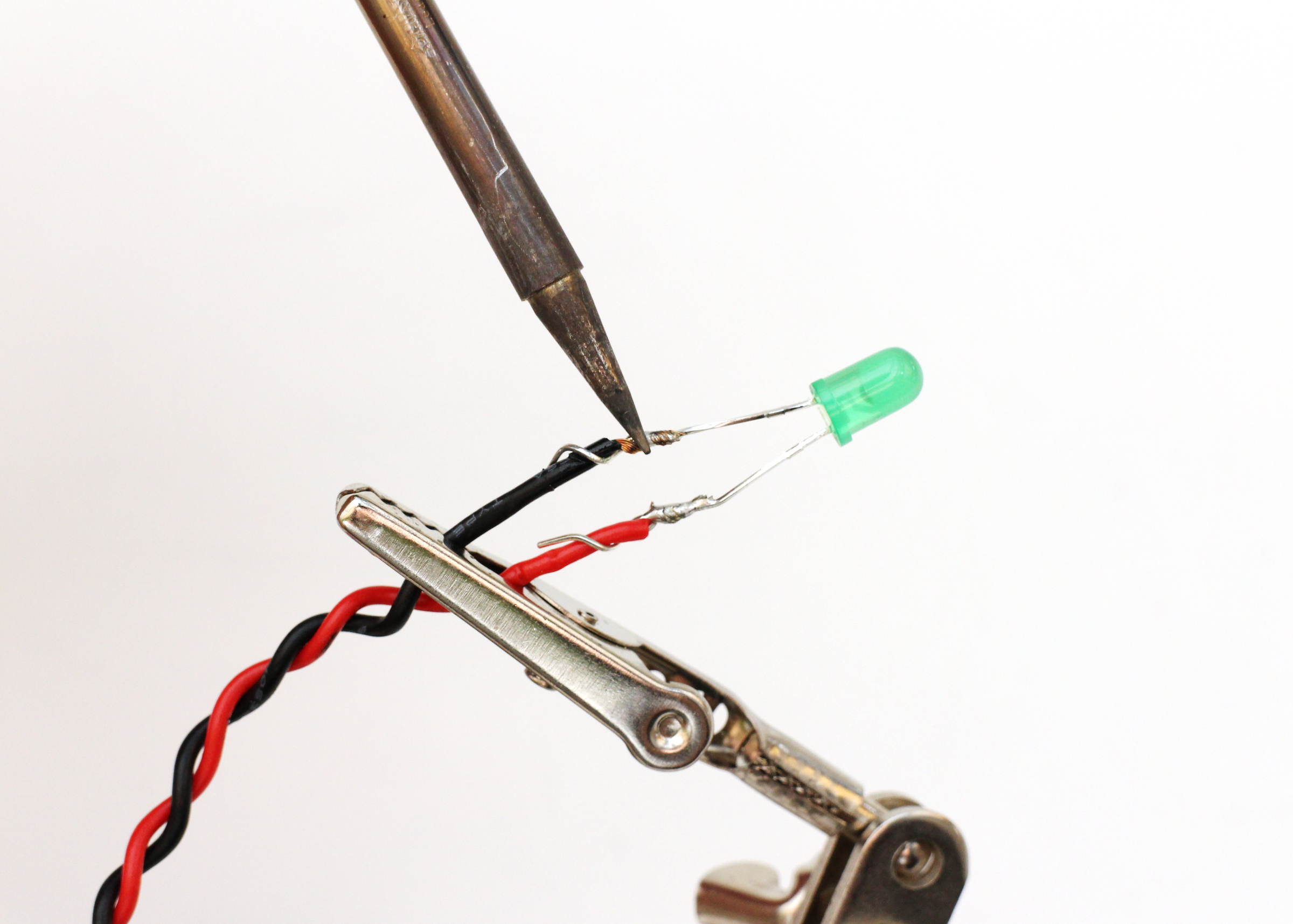

To lengthen the LED's I used red and black copper wire. I first stripped both ends with the universal wire stripper. Remember that the negative side of the LED is the shorter side, so make sure to attach the black wire properly so you don't accidentally fry the LED.
Then I twisted each wire around the legs of the LED and soldered them together. If you need a refresher on how to solder check out this Instructable.
For bonus points I spun the wire in a drill to keep everything neat and tidy.

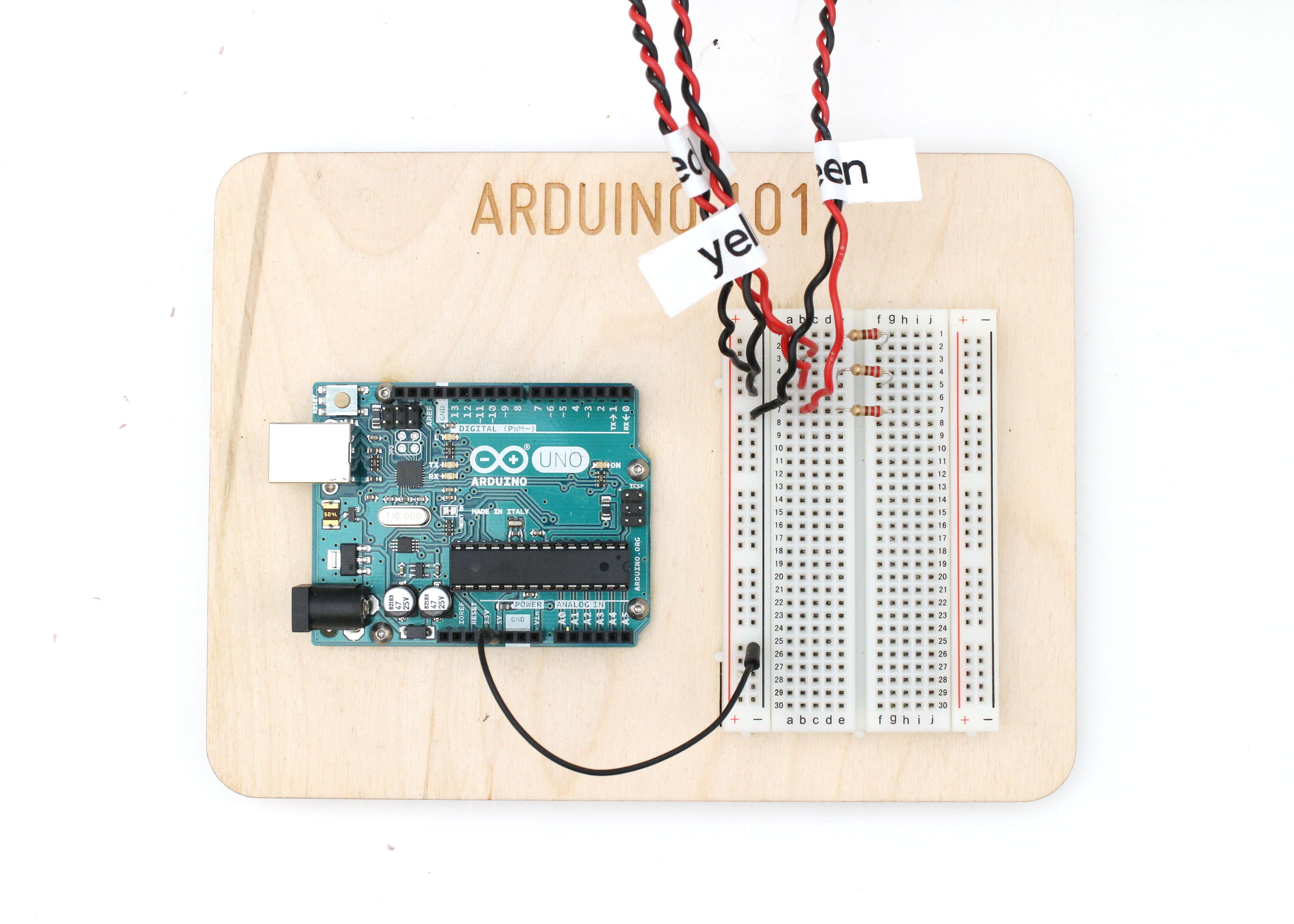

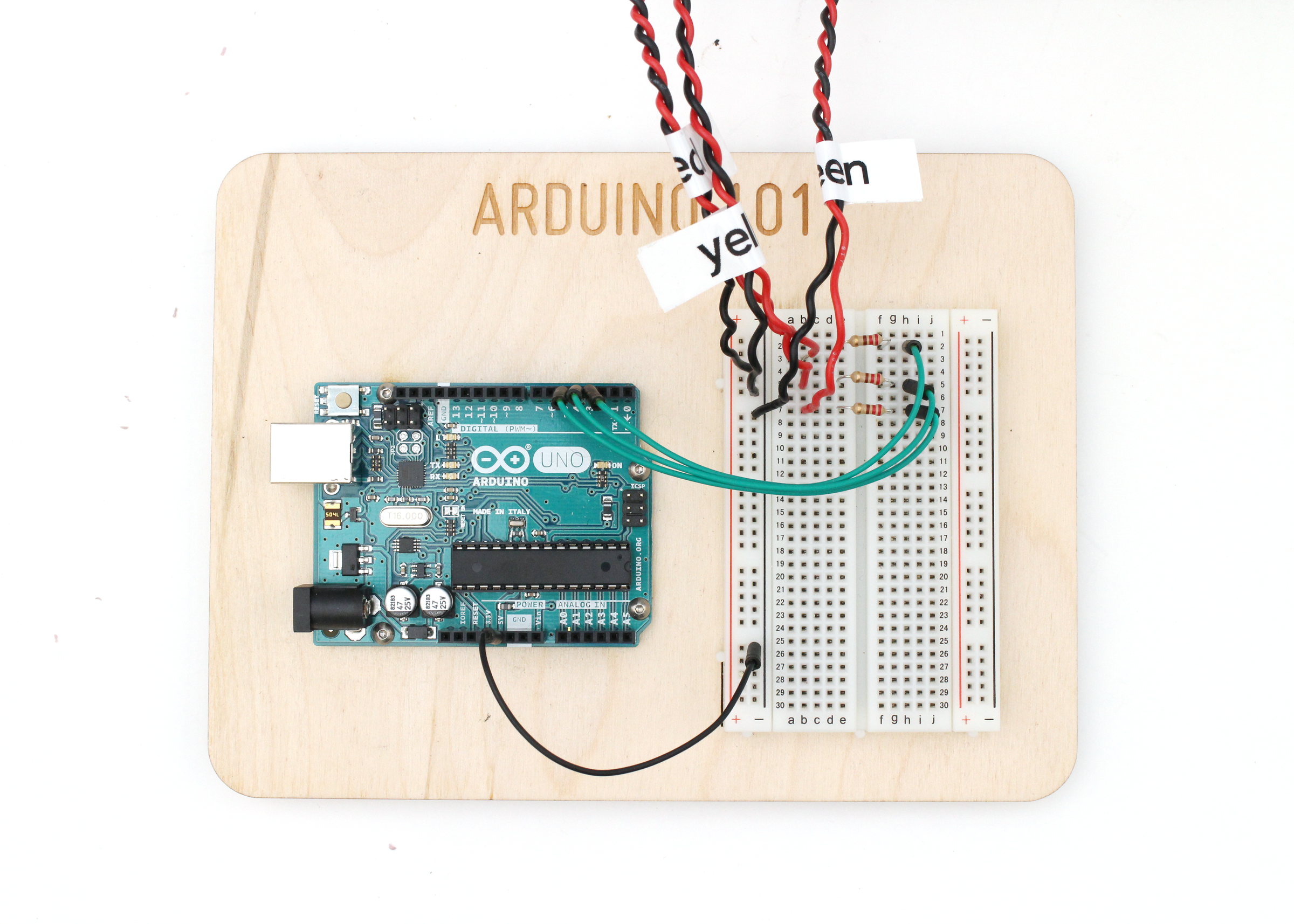

Step 7: Breadboard Circuit Part 1
For this project we are going to want each LED to be controlled by a different pin on the Arduino. This requires us making three different circuits for each LED (don't worry this is way easier than it sounds). First plug the black wire of each LED into the negative (Ground) side of the breadboard, and run a jumper cable form the GND pin on the Arduino to the negative rail of the breadboard.
Next we are going to add three resistors onto the positive side of each LED. You want resistors that have two red stripes followed by a brown stripe. Place the resistor across the center of the breadboard. This ensures that the two ends of the resistor are not electrically connected.
To finish off this step we are going run jumper wires from pins 3,4 and 5 to the Red, Yellow and Green LED's.
