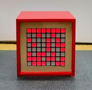

  The IMU sensor module should be placed exactly in that position as you see in the pictures. Now let's see how the device works in reality.
Step 3: Dispaly Modes

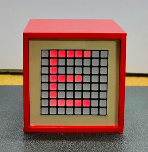

This clock has several display modes that can be changed by rotating the case for 90 degrees. When switching on, the current time appears and the hour is represented in the middle with a 5×7 font, and the minutes are represented on the edges, with a resolution of 5 minutes (more precisely, the distance between two diodes is 5 minutes).
Now if we rotate it to the left by 90 degrees, it shows the current room temperature in degrees Celsius
 One more time to the left by 90 degrees and we enter a mode where the time is written in words.
 Finally, by rotating again to the original position, the current time is presented again
