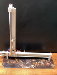

In this project, I'd like to share how to build a 2-axis thermocol/ polystyrene cutting CNC machine with its frame and supports made of electrical wire casing/duct and 3D printed parts. Basically it is a thermocol cutting tool which can be used to cut different shapes from the thermocol sheet. It can be used as a craft making tool. The idea of using electrical wire casing / duct as linear rails makes the whole machine affordable and of less weight. With this cutter you can easily cut Thermocol / polystyrene, styrofoam or any other similar material.
This machine is made up of easily available parts like 28byj-48 Stepper motors, Arduino nano, old radio antenna rods, string / thread and 3d printed parts. Hope you like this Idea.

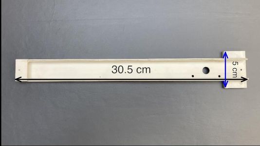

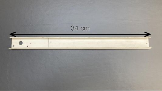

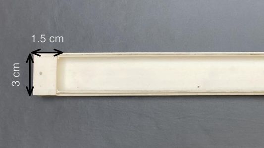

The dimensions of casing to be used as linear rail and a Aluminium composite panel sheet (34cm X 13.5cm) used as a Base .
All Other parts like slider for both X and Y axis are made up electrical wire casing.
Total casing/duct parts required:
Linear rail dimensions:
For X-axis = 34.0 cm
For Y-axis = 30.5 cm
For X-axis Slider = 5.0 cm
For Y-axis Slider = 6.0 cm

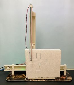

The Thermocol Cutting Cnc general part includes two 28BYJ-48 stepper motors controlled by Arduino Nano with the help of two ULN2003 stepper motor drivers. The X-axis and the Y-axis of the plotter are made up of electrical wire casing/duct. The making of linear rail from casing/duct came from the idea that the upper part of the casing with small length slides smoothly on the other part of the casing.
 X axis move linearly forward and backward relative supported at the ends with the 3D printed stands and Y axis move linearly up and down which carries nichrome wire holding rods.

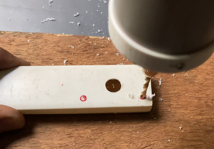

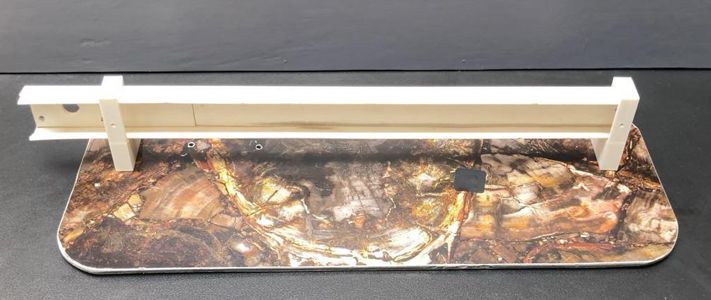

Take a aluminium composite panel sheet and cut a piece of size 34cm x 13.5 cm
Drill required holes on the sheet to hold 3D printed stands. These two 3D printed stands supports X-axis.

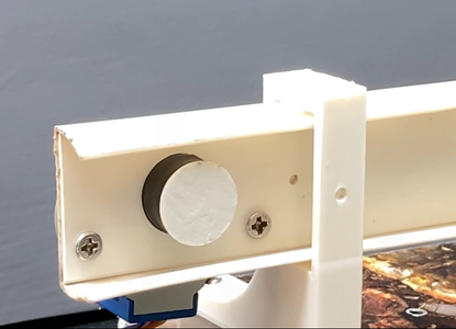

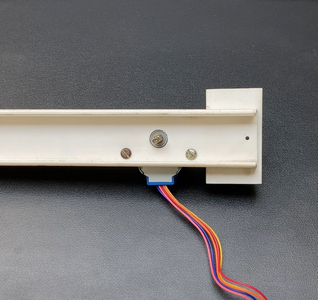

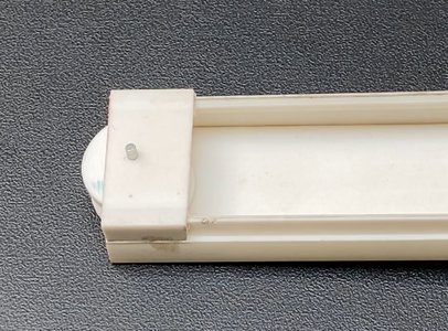

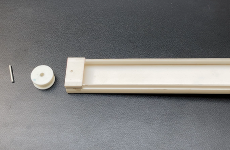

X-axis consists of an electric duct casing attached with a stepper motor. For the pulley of the stepper motor I have used an old gas cylinder washer attached to a 3D printed pulley. This washer helps in gripping the string.
Make necessary holes on the electric duct casing to hold stepper motor on one side and idler pulley on other side with a mini drill machine.
Also cut a small part of upper duct casing to hold idler pulley as per the dimensions shown in images.
The slider for X-axis made from cutting a 5cm piece of upper part of duct casing.
Similar steps to be followed to built Y-axis but the length for the slider for Y-axis is 6 cm.

Attach the pulleys on each stepper motor and tied up the string/thread between the motor pulley and the idler pulley of both axis. Use springs to hold the string/ thread in proper tension.

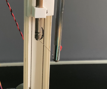

Nichrome wire holder consists of two antenna rods one inside the other. I got these hollow rods from my old radio set. The outer diameter of these two rods are 6 cm and 7 cm.I designed 3D printed holders to hold these rods apart at a distance of 5cm.
Two 3D printed parts are also designed to hold these rods with the slider of the Y-axis as shown in the images.
One hole is drilled on each rod 1cm far from one end of the rod to take out wires from these holes. A screw is attached at one end of each rod to hold the wires from power supply and Nichrome wire.
The temperature of the Nichrome wire controlled with a PWM motor speed controller powered with 9v DC supply. Adjust the knob of PWM Controller to change the current input to the Nichrome wire.

Attach the X-axis stands on the base plate made up of aluminium composite sheet with the help of screws. Hold the X-axis casing inside the cavity provided in the 3D printed stands.

Step 9: Working
Connect USB Cable to Arduino Nano port, 5V DC power to the power port and 9V DC power to the PWM motor speed controller.
I have used a PVC plastic sheet having 5 nails on it to support thermocol sheet vertically.
Cut a 15cm X 15 cm thermocol / polystyrene sheet and place this sheet on the nails provided on a PVC sheet.
Paste this PVC sheet on the base plate with the help of double-sided tape.
Open UGS, select Port and set Baud to 115200, click on Connect tab.
Set the original coordinates by button Reset Zero. It should be located in the lower left corner.
Click Open > Browse to the G-code file "PLUS.gcode".
Click Send button and Arduino CNC Cutter will start cutting the thermocol / polystyrene sheet.
