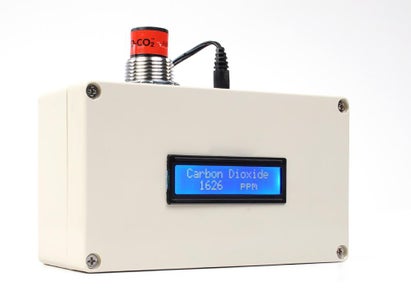

Introduction: Arduino CO2 Meter
In this project, we will be making a benchtop-style CO2 meter using the sensor from Atlas Scientific hooked up to an Arduino Uno. The real-time readings in PPM will be shown on a liquid crystal display (LCD). Both the sensor and display are connected to the Arduino via I2C.

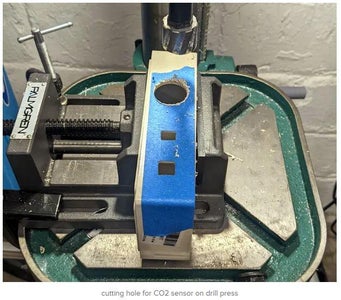

Step 3: Prepare Enclosure: Opening for Co2 Sensor
a) On the same side as the Arduino ports, mark off the spot for the CO2 sensor and drill a (1/4") pilot hole.
b) Using a (1" 1/16") annular cutter, cut the hole for the CO2 sensor.
