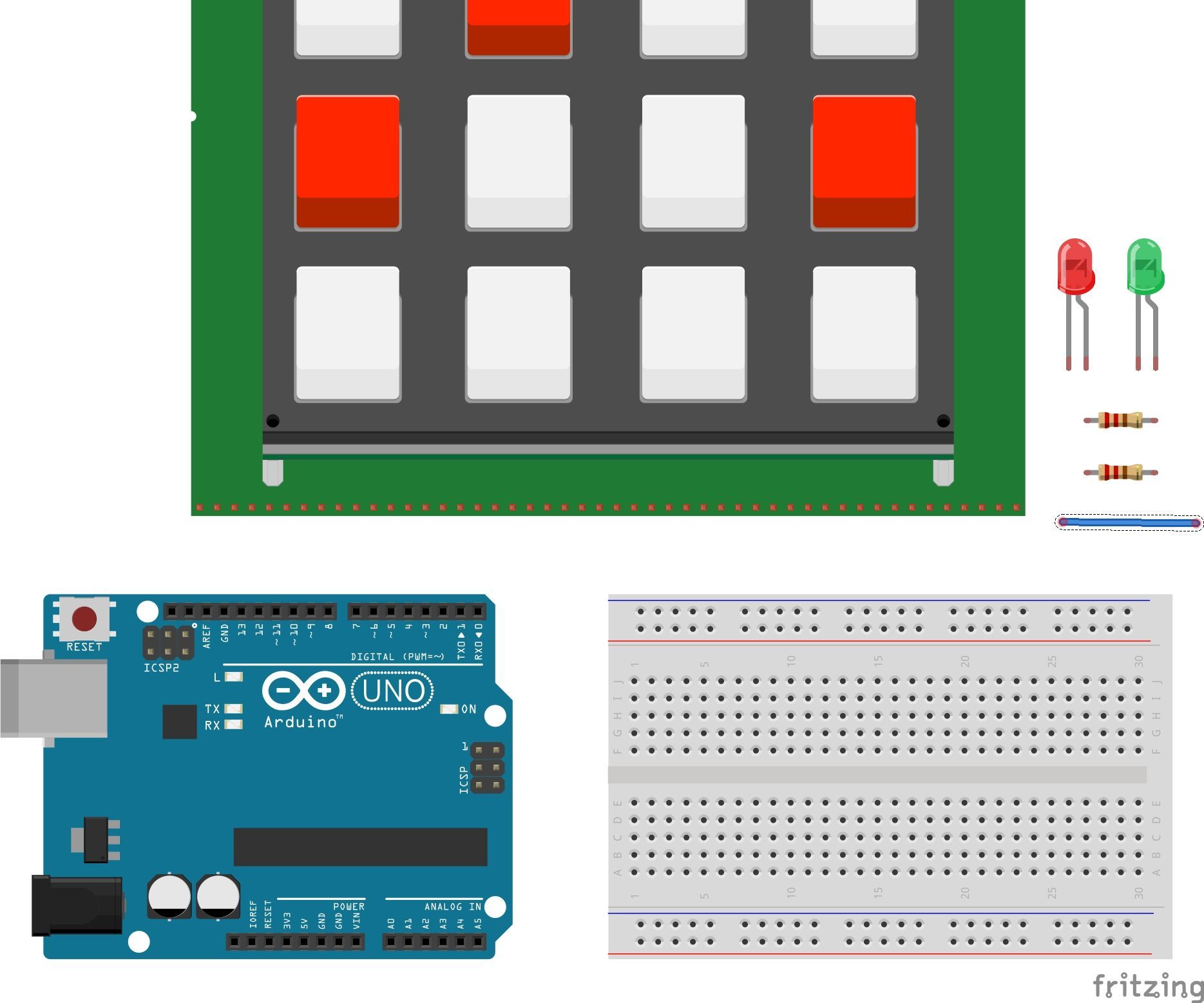

Step 2: Connecting the Keypad to the Arduino
Now we'll connect the 4x4 Keypad to the Arduino. The Membranous 4x4 Keypad that I used isn't offered in the Fritzing diagram, so I improvised with this 4x4 button pad as a placeholder. The number pad that I used only has 8 ports and I tried to make it as clear as possible for this diagram.
For this step, connect the four pins on the left to ports 2, 3, 4, and 5 on the Arduino.
Now connect the other four pins on the right side of the number pad to ports A5, A4, A3, and A2 on the Arduino.
Step 3: Connecting All of the Components
By this time, you should have a fully functional Arduino based calculator. Now just use the code below to get it working!
Step 4: Number Pad Diagram
This is how I formatted the number pad with the Arduino.
