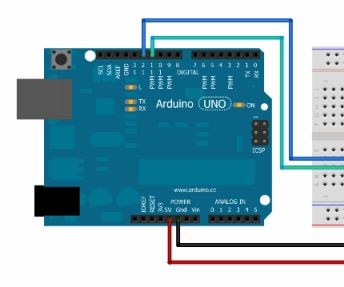

Step 3: Building the Hardware
1) Connect Arduino to your computer
2) Connect LED to breadboard and the Arduino as shown in the picture.
