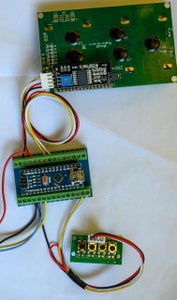

At the heart is an Arduino Nano board, costing less than £2. An Arduino Uno board would work as well, but not fit into the screw-terminal board.

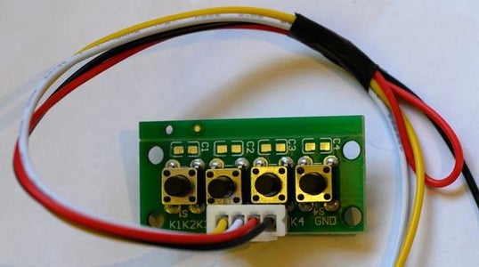

Two push-buttons are required (a four-button module is shown in the photo)
The sensors are pre-made modules and the light sources are a matching pair of very low power Lasers. Again all readily available at cheap prices.
The test results are shown on a four line LCD module and optionally can be displayed on the computer screen, which gives more detail than the LCD alone.

The Arduino is easily connected to the modules, either using Dupont wires, which Arduino users will be familiar with, or pre-made JST XH connectors, which cost little more than Dupont wires.
There is no soldering required, although it can make things a little neater when connecting the sensors, as there are lots of 5V and 0V wires.
The comprehensive build guide and schematic diagram is attached.

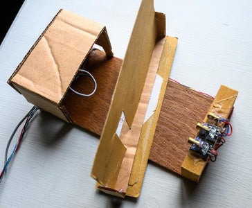

The photo shows the sensor frame, simply made from scrap wood, with the sensors & Lasers hot-glued in place.
This works very well. Other users have used project boxes or even 3d printed parts to make a neat sensor frame.
The central card is a test piece, to simulate the slot in a focal-plane shutter.
