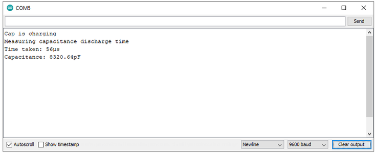

Lastly, the arduino code allows you to calibrate the device using linear regression upon giving it a few capacitors to measure. To initiate this process make sure the following lines are equal to 0
double capacitancePerTime = 0; // proportionality constant for t=kC [pF/us]
double capacitanceOffset = 0; // offset for model
With that out of the way, test it out and see how you go! The next step will be evaluating the performance of this device.

In previous calibrations, I obtained a k value of about 200. Given the time step of 4µs, this leads to an uncertainty of about +/-800pF.
More investigation should be done for uncertainty factors 2,3,5 however based on experimentation it seems as though +/-1nF is a reasonable uncertainty.
