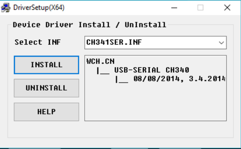

Step 2: Installing Process:
1) Download the drivers using link given above.
2) Extract the divers and install them.
Step 3: Paste Ch341.SER Extracted Folder File to Arduino Driver Folder.
Step 4: To Make Sure They Are Installed, Search Device Manager and See Ports Options.
