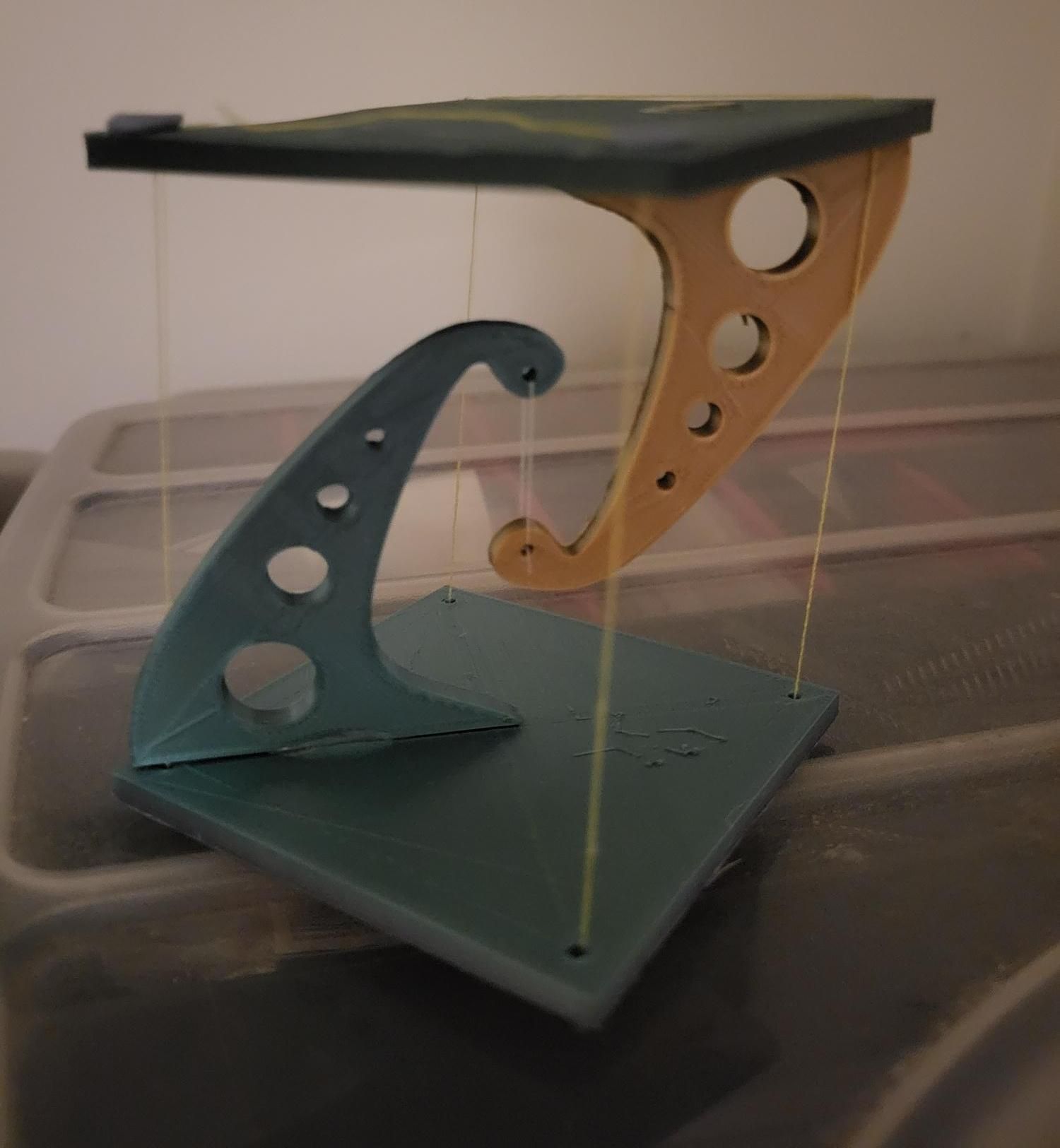

Step 4: Physical Build
The next phase is the physical build.
Rocker switch
The first piece is to build the rocker switch. This switch must close one of two connections but never both. Also it must be able to balance in the middle where it closes neither connection. This pauses the clock. Here I used a small length of wood and screwed a UK ground pin to either end. Then a pivot is built in the middle to raise the rocker off the board. Again I used my ebay meccano extensively for this bit. When the rocker is mounted onto the board the ground pins need to go into the fuse holder clips to close the connection. To make this have a smooth feel I filed down the edges of the ground pins so the go into the fuse holder move easily (see image).
Layout
I first mounted the empty PCBs onto a perspex sheet with a gap for the pivot of the rocker switch. Then I took it back off and soldered the components and wire in with the same gap. If you do not do this you may find it difficult to bolt the resulting boards back onto the perspex of base.
Draw the layout out on paper first and bear in mind:
- how high the 'up' side of each rocker will be for the housing
- some components like the battery holders and Arduino USB port need to be accessible after completion
- If switches are to be mounted on a lid of the housing then connect their wires with connectors so the lid can be completely removed. (mine only has a hinge but I did this anyway)
- I tilted the 7-segment displays by extending the pins on one side with fuse wire which allows that side to sit higher out of the board
Housing
I had planned to build a custom housing but in the end I did not have enough time and the perspex is difficult to cut so I bought a box that was similar size to what I needed and modified it a bit. I think it is good to have transparent casing so the workings can be seen but make sure that the batteries and the USB port remain available for program tweaks.
That's it have fun and good luck!

Step 6: 2019 Update!
so I returned to my first Instructable and made this chessclock again!
I followed the same steps more or less but with the following improvements:
Physical build
- The whole build is more compact and on a wooden base (see photos)
- Switched to a single 9v battery connected direct to the VIN and GND by a switch
- The rocker switch is meccanno where each side is held down when pressed by superstrong magnets.
Code
I also improved the code which is attached here. improvements are:
- Ditched the display of 10ths of a second and shifted digits right
- Added increments. Added 5 mins plus 5 secs per/move and 10 mins plus 5 secs per/move as options
- Added a coupe of lines to switch the displays (L <=> R) if you find after the build that the rocker switch does not start the correct clock
