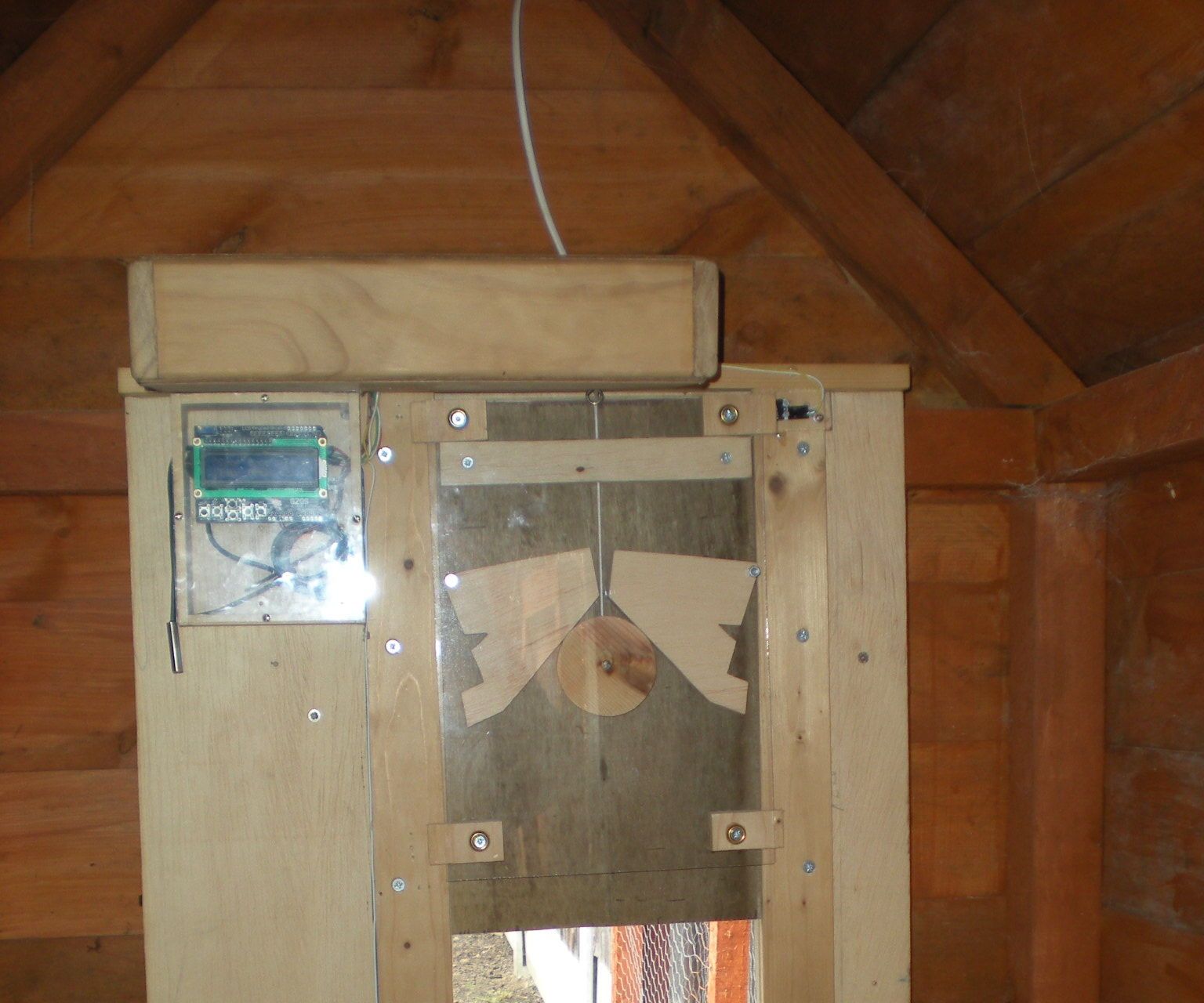

Step 1: Building the Door
Clint didn't actually provide the plans on his YouTube link so I set about to recreate them and I have attached a PDF file which you can scale to your needs. I hope from the series of pictures and my video file you can see how the door assembles and works.
Some pointers:
- I would advise using the acrylic sheet facing plate rather than plywood as it provides a frictionless face for the pieces to move freely
- You really need to see it moving to make sure it works freely and you know where to make any tweaks
- It really looks cool and you should show off your handy work
Use brass screws/stainless steel bolts where possible and treat the ply with a suitable wood preserve - I wouldn't use a vanish as this might over time cause the workings to foul. When fixing the perspex cover use brass screw cups to spread the load and will hopefully stop the cover from shattering.
I found loosely fitting the door lock levers ensured they worked even if they were damp from the outside weather. I made two doors to test. One has been in manual use to see how it would stand the damp and cold english weather - which it did! So hats off to you Clint it is a very practical design.
I have taken loads of pictures so you can see from all angles the design and how it is constructed and assembled. I haven't commented on every picture as I think it is reasonably self explanatory - well I hope!

I mounted my motor on some formed wooden support pieces and left plenty of space for the motor controller and regulators. I housed the motor assembly so no moving parts would be pecked by my feathered friends - my coop isn't a tall shed. The pulley is an old wooden cotton real but any real would suffice - make sure you can drill a hole through it for the chord. As the real would only be moving for a few seconds up and down I didn't go overboard on bearings and tried to keep things simple.
I attached the real to the motor via a screw bit and some very strong double bubble glue- it goes rock hard when cured.

Step 8: Installing Into the Coop
Make sure the battery is nicely tucked away from the reach of the hens and the 9V input cable is securely attached to the door which is behind the motor housing.
I would reset the door and check the time is correct and the right sunset and sunrise minutes are displayed for that month. At the time of taking the photo's we were in March which meant the time section would display:
