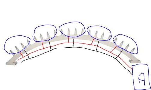

All RED must be connected together and all BLACK must be connected together. The easiest way is to have a RED and a BLACK wire that goes from one side of the candelabra to the other, and then you connect each LED to them.
There is very little current used so you can use thin cables. However, it is important that it is multi-wire and not a solid cable. Solid cables detach very easily from the soldering points and you do not want to have to open everything again to re-solder a cable.

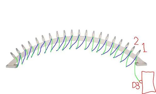

Each LED has a Din (GREEN) and a Dout (BLUE). The LED closest to your Arduino (LED1) should connect its Din (GREEN) to the Arduino Mega (Pin D3).
LED1s Dout (BLUE) must be connected to the next LED (2) Din (GREEN).
LED2 BLUE -> LED3 GREEN. The last LED does not connect its Dout (Blue) to anything.
If everything is connected correctly, you have 3 cables that go to your Arduino Mega Nano.
RED -> Connected to all RED cables on all LEDs
BLACK -> Connected to all BLACK cables on all LEDs
GREEN -> Which is close to Din on LED1

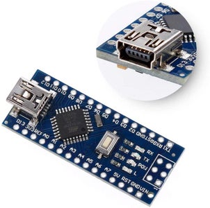

Arduino Mini Nano is a very small Arduino so try to carve out a cavity that it can fit in your candelabra. Keep in mind that you need to be able to connect a USB mini connector to power it.
NOTE! To protect your Arduino, you need a 330-470 ohm resistor between the Pin D3 and LED1. Read more about it at https://learn.adafruit.com/adafruit-neopixel-uber...
RED -> Connects to Pin 5V
BLACK -> Connects to GND or to the shield of the USB mini female.
GREEN -> Connects to D3

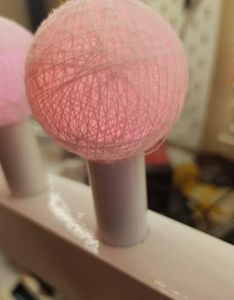

Step 4: Diffuser for the Candlestick
Now that all the electronics are working and the lights are on, it's time to attach all the LEDs and put on a ball of some kind on top.
Many people use ping pong balls as a diffuser for LEDs. Ping pong balls have a dark edge from the manufacture and you have to keep that in mind if you use them so that the edge is symmetrically placed on all LEDs.
Here is Bitluni's guide to a ping pong wall and he goes through how to work with them in the best way.
I bought a cheap Christmas light string that had clear balls with white yarn strings on. I think it turned out nicer than ping pong balls. No matter what you use, you attach it with heat glue.
