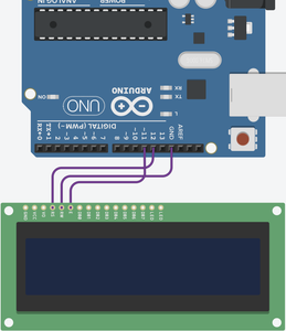

  4. Grab the LCD screen, connect two jumper cables to the VSS pin on the display to the ground, and place the VDD pin to the positive
Step 2: Connecting RS, RW, and EN Pins
  1. Connect the RS (register select) pin on the LCD to pin 12 on the Arduino
  2. Connect the RW (Read/Write) pin to the ground as it sets the LCD screen to write mode
  3. Connect the EN (enable) pin to pin 11
Step 3: Connect the Data Pins
These pins are used for sending data from the Arduino to the LCD screen for displaying different characters or commands.
  1. Connect the D4 pin on the LCD to pin five on the Arduino
  2. Connect the D5 pin on the LCD to pin four on the Arduino
  3. Connect the D6 pin on the LCD to pin three on the Arduino
  4. Connect the D7 pin on the LCD to pin two on the Arduino
Step 4: Double-check All Connections
Make sure to check if any components are lost or out of place, as it will not work if a wire is out of place.
