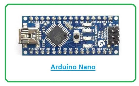

  1. Arduino Nano Board

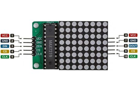

  2. Matrix Led 8x32 7219

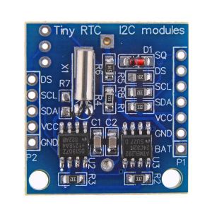

  3. RTC DS1307 clock module

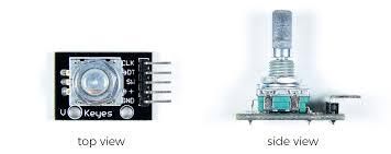

  5. Rotary encoder

  • The electrical diagram is not very complicated, it requires attention to the connections to the led matrix display 7219. Also, the led and the related resistance may be missing, but they indicate the entry or exit of the device from the programming mode.

At the time of the first test, when powered from the battery or USB, the display will show 0:00. With the help of the rotary encoder module and the push button, we program the desired time and date. As long as the blue LED is ON, the watch is in programming mode. Programming is done by rotating the rotary encoder module. Changing the programming dates is done by pressing the pushbutton in the rotary encoder as follows: 1 hour, 2 minutes, 3 date, 4 month. 5 exit programming mode.
