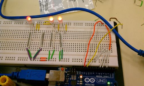

Introduction: Arduino Color Mixer
The purpose of this instructable is to show how to use an Arduino to create a color selector, for full color LEDs. The selector will have a gui interface which runs on a computer connected to the Arduino. The interface allows color selection by the use of red, green and blue slider gradients.
A video of the mixer controlling 3 LEDs is located here https://www.youtube.com/watch?v=9VBWqkRLqNs
what you'll need,
-breadboard
-full color LED's (as many as you want to use, I used 3)
-Arduino Uno
-breadboard, wire, ect..

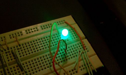

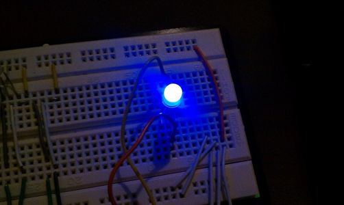

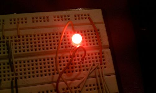

Step 1: Connecting and Testing LEDs
the first thing to do is to connect 1 led to the breadboard, and the arduino. Each full color LED has 4 connections, it has a shared anode which is connected to one of the digital pins set as a +5V output. The LED also has a cathode for each color, red, green, and blue.
the easiest way to test the LEDs is to put them into the bread board, then set 1 of the arduinos digital pins to an output and the other to a input, the code to do this(using pins 11,and 12) is:
void setup() {
pinMode(12,OUTPUT);
void loop() {
//this sets pin 12 to 0 volts so it allows a full voltage drop accross the LED
digitalWrite(12,LOW);
//I used analogWrite here because applying the full 5 volts to the LED may damaged it.
// or you could just use resistors
analogWrite(11,10);
Once you have figured out which cathode is which for each LED connect them in parallel, so that the +5V is shared by each Anode, and each red cathode for each LED is connected to pin 3, each green cathode is connected to pin 5, and each blue cathode is connected to pin 6. Once this is done the following code can be used to control the color of all of the LED simultaneously.
// with all values set to 255 the led will not light up, to test each color independantly just change the value
// of that color, the closer the value is to 0 the brighter that color will shine. Color mixing is achieved by having different values for red,
// green, or blue.

Step 2: Color Mixer Software
Once You have all of your LEDs connected, the next step is to write the mixer software that runs on the computer.
the code is:
