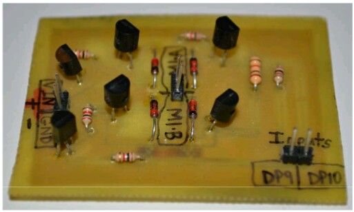

So here is my first instructable,Coming to the topic,this is an arduino compatible colour sensor that is extremely made at low cost(don't go on the image I ruined it whole while de attaching it from the robot)....

Step 3: The Etching Traces
The traces should look like this,you may be wondering what is the use of all pins???,because of lack of male header pins,I used them as a connector(by cutting off their heads)...
