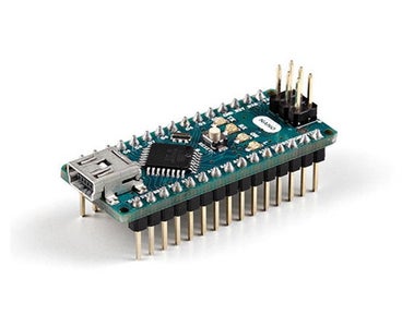

Arduino nano - 1

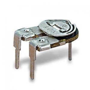

variable resistor 10K - 1

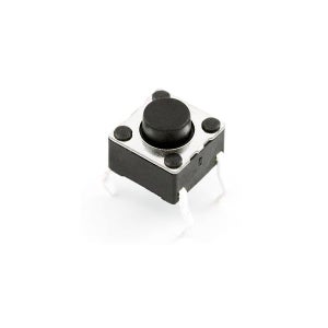

push switch - 1
on/off switch - 1

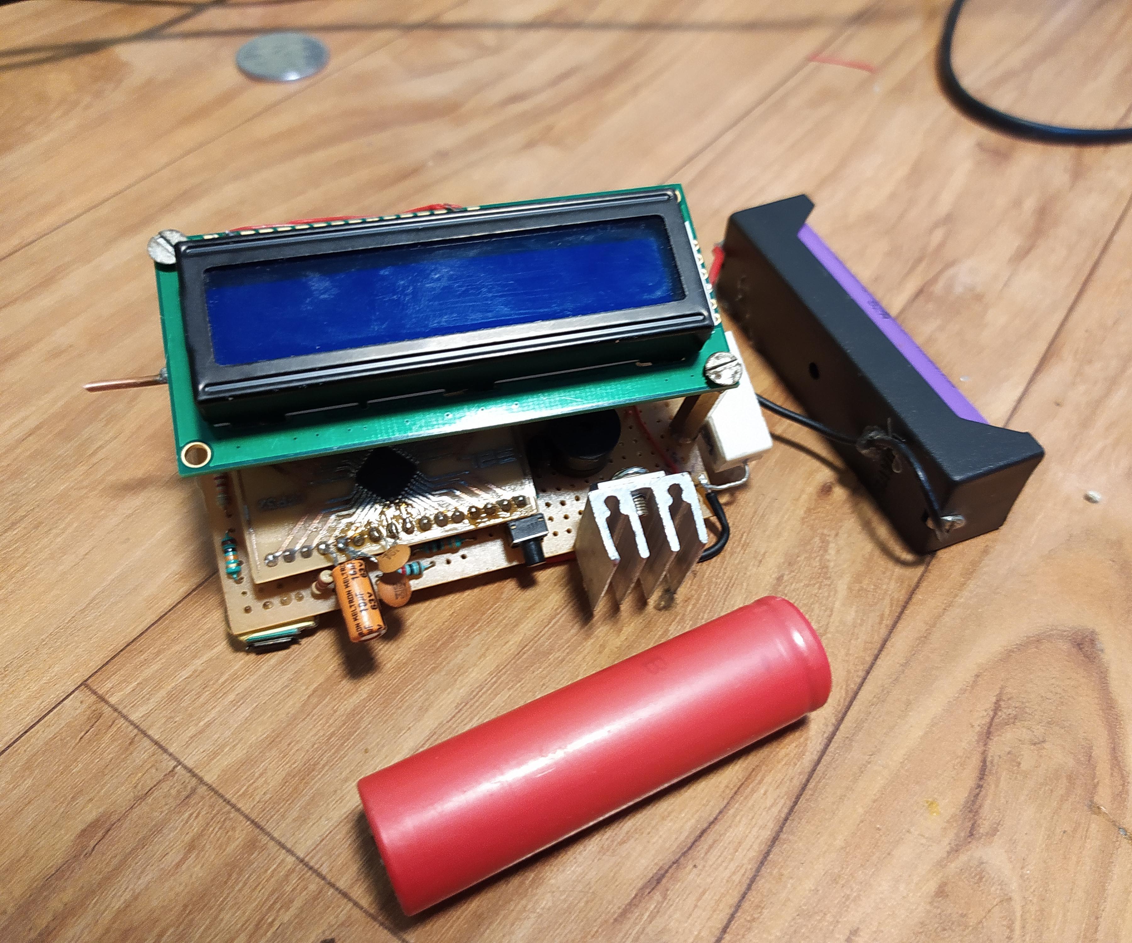

Step 5: Some Test
Now it ready to be use.
Some tests you can show
Just connect the component to the probe and push the button.
If you want to use PWM function just long press the push button.
