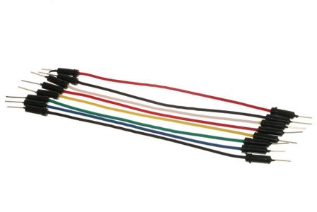

  • Jumper wires

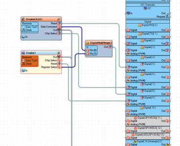

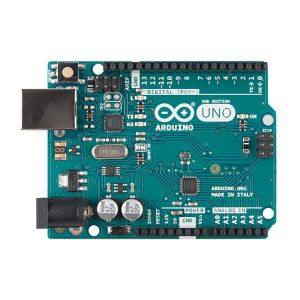

Step 3: Start Visuino, and Select the Arduino UNO Board Type
The Visuino: https://www.visuino.eu also needs to be installed. Download Free version or register for a Free Trial.
Start Visuino as shown in the first picture Click on the "Tools" button on the Arduino component (Picture 1) in Visuino When the dialog appears, select "Arduino UNO" as shown on Picture 2

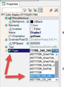

Select "Display1" component and in the properties window select Type: dtST7789_240_240

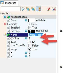

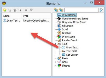

  • Double click on the "DisplayOLED1" component and in the Elements window Drag "Draw Text" to the Left Side and in the Properties window set size to 3 and text to: SPI1
  • Close the Elements window
  • Double click on the "Display1" component and in the Elements window Drag "Draw Text" to the Left Side and in the Properties window set size to 3 and text to: SPI2
  • Connect "DisplayOLED1" pin [Reset] to Arduino digital pin[5]
  • Connect "DisplayOLED1" pin [Data Command] to to DigitalMultiMerger1 pin [0]
  • Connect "DisplayOLED1" pin [Out SPI] to Arduino pin[SPI In]
  • Connect "DisplayOLED1" pin [Chip Select] to Arduino digital pin[7]
  • Connect Display1 pin Out SPI to Arduino board pin SPI In
  • Connect Display1 pin Reset to Arduino board digital pin 9
  • Connect Display1 pin Register Select to DigitalMultiMerger1 pin [1]
  • Connect DigitalMultiMerger1 pin [Out] to Arduino board digital pin 8

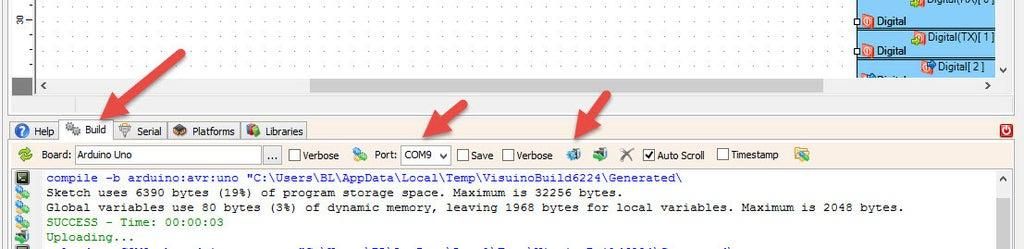

Step 5: Generate, Compile, and Upload the Arduino Code
In Visuino, at the bottom click on the "Build" Tab, make sure the correct port is selected, then click on the "Compile/Build and Upload" button.
