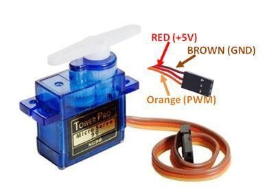

  • Connect Servo motor "Orange" (signal) pin to Arduino Digital pin[2]
  • Connect Servo motor "Red" pin to Arduino positive pin[5V]
  • Connect Servo motor "Brown" pin to Arduino negative pin[GND]

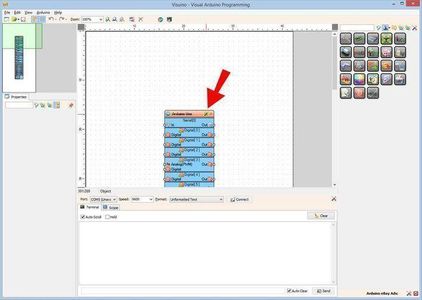

Step 3: Start Visuino, and Select the Arduino UNO Board Type
The Visuino: https://www.visuino.eu also needs to be installed. Download Free version or register for a Free Trial.
Start Visuino as shown in the first picture Click on the "Tools" button on the Arduino component (Picture 1) in Visuino When the dialog appears, select "Arduino UNO" as shown on Picture 2

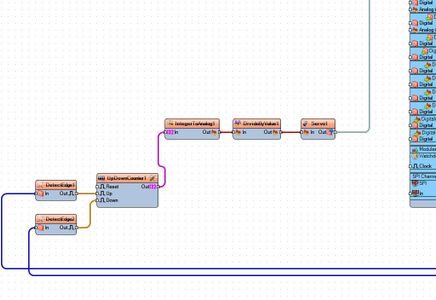

Step 4: In Visuino Add & Set Components
  • Add 2X "Detect Edge" component
  • Add "Up/Down Counter" component
  • Add "Integer To Analog" component
  • Add "Divide Analog By Value" component
  • Add "Servo" component
  • Select "UpDownCounter1" and in the properties window set Max > Value to 10 and "Roll Over" to False
  • Select "UpDownCounter1" and in the properties window set Min> Value to 0 and "Roll Over" to False
  • Select "DivideByValue1" and in the properties window set Value to 10

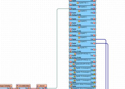

Step 5: In Visuino Connect Components
  • Connect Arduino Digital Pin [8] to DetectEdge1 pin [In]
  • Connect Arduino Digital Pin [9] to DetectEdge2 pin [In]
  • Connect DetectEdge1 pin [Out] to UpDownCounter1 pin [Up]
  • Connect DetectEdge2 pin [Out] to UpDownCounter1 pin [Down]
  • Connect UpDownCounter1 pin [Out] to IntegerToAnalog1 pin [In]
  • Connect IntegerToAnalog1 pin [Out] to DivideByValue1 pin [In]
  • Connect DivideByValue1 pin [Out] to Servo1 pin [In]
  • Connect Servo1 pin [Out] to Arduino board digital pin [2]
