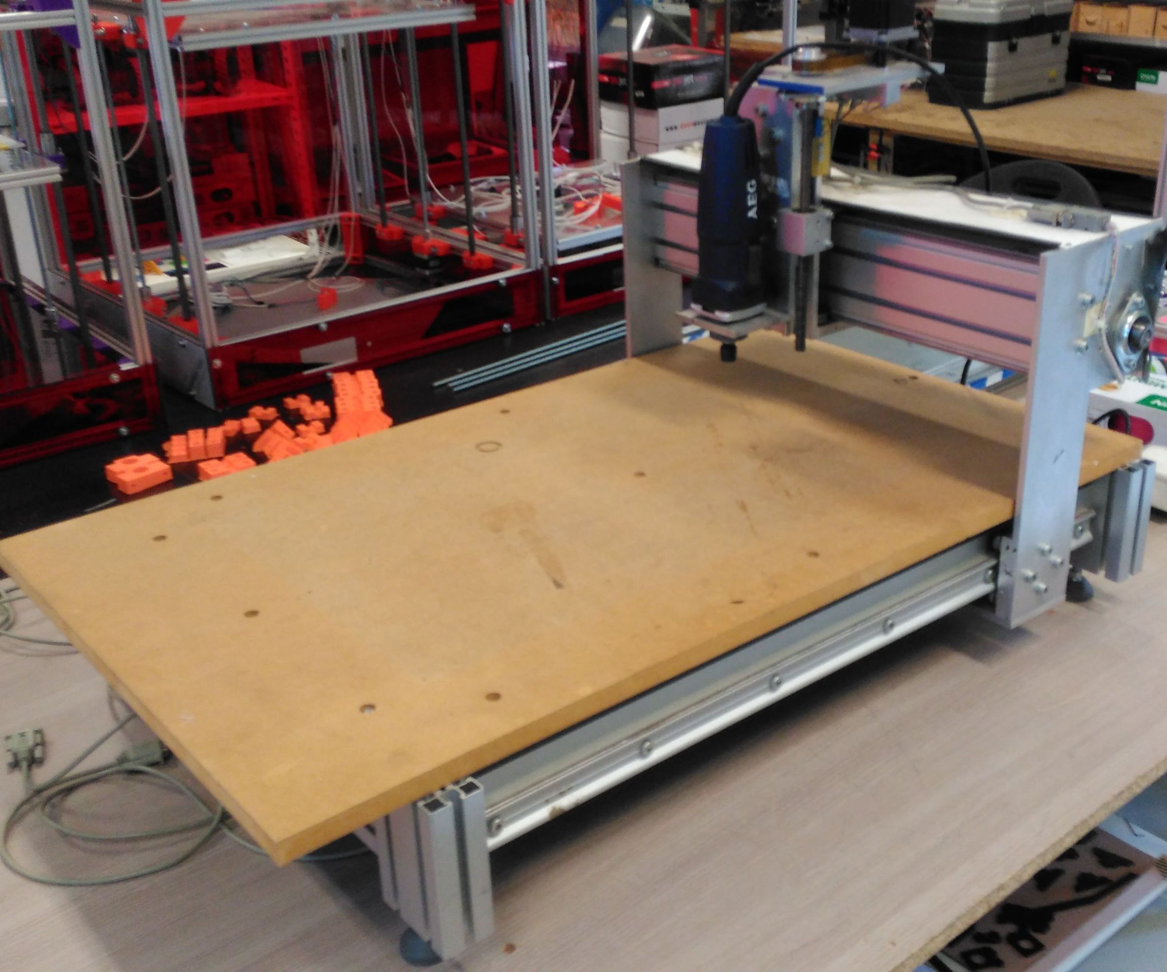

The BuildersBot technical CNC specs:
- Kress Spindle
- Working volume of 50x70x20 cm.
- Precision (to be calculated as soon as i get the tools)
Instructions for CNC Milling:
This is the CNC work flow protocol I use:
- Mount the Kress Spindle with a drill-bit no to the BuildersBot tool holder
- Prepare and align the CNC bed in all 4 corners
- Prepare the stock material to mill (Acrylic, wood, aluminium etc)
- Secure the stock material in place
- Turn the electronics power on
- Turn the Repetier Software on
- Home in the X and Y axis (according to stock material)
- Manually home in the Z axis (according to stock material)
- Load your GCode file into Repetier Software ( Generate a GCode File, using any CAM software )
- Turn the Spindle on
- Adjust Speed on Repetier (speed rate)
- Press Play to start milling
CNC milling resolution, repeatability in 10 mm Acrylic sheet using 2mm depth passes:
- Using a digital clipper the measured repeatability error is in the range of 0.1 - 0.3 mm (photos)

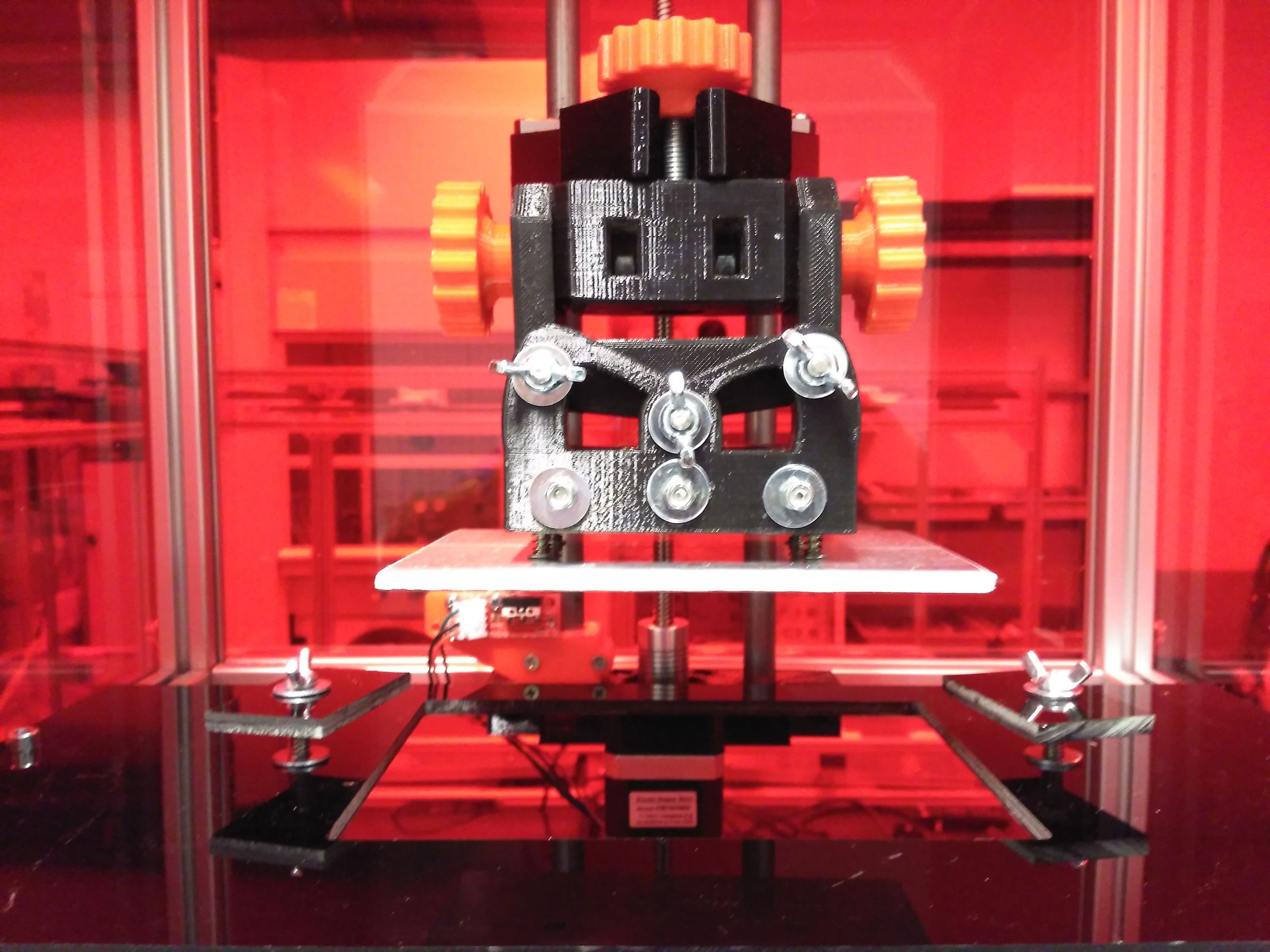

Step 15: 3D Printing
The objective:
Fit the BuilderBot with an extruder and filament holder that will allow it to perform 3D Printing.
This feature allows the printing of very big object (500x700x200 max volume)
The Z axis allows the printing of height objects, and the idea is also allow the fitting or other extruders that will come out in the future, such as metal and cement printing.
The extruder is mounted on the tip of the tool holder, it is a version of Greg's extruder and has a 0.5mm J-head hotend. It can be mounted or unmounted from the tool holder by simply unbolting 2 bolts.
The cable connections connect the extruders motor, the fan, the hotend resistor and the thermistor.
Step 16: Greg's Extruder Mount
The extruder mount price can be attached to the Builderbot using 3 bolts. It can house three 4cm fans and a Gregs extruder.
