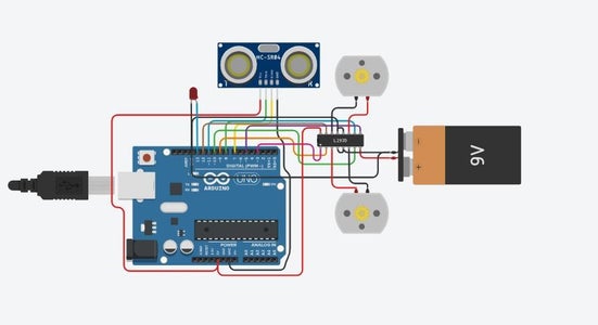

Step 1: Circuit Connection

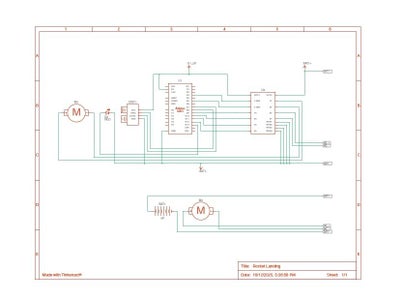

The wiring below assumes an H‑bridge that has separate EN (enable/PWM) pins and IN pins for direction (common for L298N and similar drivers). Check your driver's datasheet and adapt pins accordingly.
Pin mapping used in software
  1. motorPin1A (IN1) → Arduino pin 9
  2. motorPin1B (IN2) → Arduino pin 10
  3. motorPin2A (IN3) → Arduino pin 11
  4. motorPin2B (IN4) → Arduino pin 12
  5. enA (ENA PWM) → Arduino pin 3 (PWM)
  6. enB (ENB PWM) → Arduino pin 5 (PWM)
  7. trigPin → Arduino pin 8
  8. echoPin → Arduino pin 7
  9. ledLanding → Arduino pin 13
Wiring steps
  1. Power
  2. Connect the H‑bridge motor supply input to your external motor battery (observe polarity).
  3. Connect the H‑bridge ground to the Arduino GND (common ground is required).
  4. If your H‑bridge has a 5V regulator output and you intend to power Arduino from it, read the module manual carefully — usually it’s safer to power Arduino separately or from USB for programming.
  5. Motors
  6. Connect Motor A wires to the H‑bridge motor outputs A.
  7. Connect Motor B wires to the H‑bridge motor outputs B.
  8. Control pins
  9. Wire IN1 → Arduino 9; IN2 → Arduino 10; IN3 → Arduino 11; IN4 → Arduino 12.
  10. Wire ENA → Arduino 3 (this will receive analogWrite() PWM signals).
  11. Wire ENB → Arduino 5 (PWM).
  12. Ultrasonic sensor
  13. Vcc → 5V (Arduino)
  14. GND → GND
  15. TRIG → Arduino 8
  16. ECHO → Arduino 7
  17. LED
  18. Connect LED anode (long leg) to Arduino 13 (or to a 220Ω resistor then to pin 13).
  19. Connect LED cathode to GND.
  20. Serial Monitor
  21. Connect Arduino to your computer via USB so you can view debug prints at 9600 baud.

Step 3: Tinkercad Simulation
Tinkercad is a great place to simulate the circuit before building it physically. Follow these steps to build the simulation:
  1. Go to [Tinkercad Circuits] and create a new Circuit project.
  2. Drag an Arduino Uno and place it on the workspace.
  3. Add an HC‑SR04ultrasonic sensor and connect Vcc→5V, GND→GND, TRIG→pin 8, ECHO→pin 7.
  4. Add an H‑bridge (L298N) or two motor drivers (Tinkercad includes L293D toggle) and place two small DC motors.
  5. Wire motor driver IN/EN pins to Arduino pins as per the pin mapping in the "Circuit Connection" section.
  6. Place an LED and connect through a 220Ω resistor to pin 13 and GND.
  7. Copy/paste the Arduino code into the Tinkercad code editor (select Arduino mode) and upload to run.
Simulation tips:
  1. Tinkercad's motor models are simplified; use the serial monitor and printed distances to validate logic.
  2. Use Tinkercad’s variable resistor or button to emulate ground proximity if you need precise test cases.
