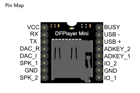

This is a bit of a complicated project so it is very important that you breadboard it first. This is mainly because the DFPlayer is difficult to deal with and you should check that you have all the software working and the Arduino talking to the DFPlayer before you actually build it. I'll discuss more on that later.
Use the Arduino Uno board for your microcontroller. Put the DFPlayer and LEDS etc. on the breadboard and connect them to the Arduino UNO with jumper cables. Use the +5V pin on the UNO to power everything.

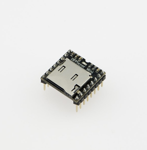

Step 3: DFPlayer Weird and Strange Behaviour and What to Do
This was one of the most frustrating Arduino projects I have ever done mainly due to the DFPlayer. Here are the issues and some solutions:
- I bought 5 modules. I'm glad I did. One didn't work at all, a second one broke somehow when I was putting the circuit board into the box and would not hold the SD Card in. So these modules are physically delicate and possibly unreliable.
- I used a programming dongle to program the Atmega 328P microcontroller on the PCB. This worked until I installed the DFPlayer then refused to work. I have several different dongles. None of them will work with it connected to the Atmega 328P. I don't know why, can't figure that one out. So the programming port and header I provisioned are useless unless you unplug the DFPlayer.
- When you go to save your sound files on the SD Card, first make sure the card is formatted as FAT32.
- You need to number the MP3 Files on your SD Card as 0001, 0002 etc. or 001, 002 etc. Otherwise it won't recognize them.
- Your files need to be MP3 type files.
- Once you place your files on the SD Card, the DFPlayer then does not like it if you change anything such as the file names or order. It will remember the configuration you first used and gets confused if you change it. It will often play the wrong files if you do this. So best thing is to decide what sound files you want to play and in what order and copy to your SD Card once only. This is because it uses the index numbers for the file not the file name. If you copy a file called 0001.mp3 on the the sd card, and then copy a file called 0004.mp3 on to the card, when you call for it to play a file called 0002.mp3, copied at some other time, it won’t play that file it will play the 0004.mp3 file because that was the second file copied to the drive and it has the index of 2 assigned to it because of the order in which you copied things onto the sd card.
- If you do need to change the MP3 files on your SD Card here are things you can try to get around the above issue:
- Completely erase all files on the SD Card and then copy all files you want onto it again.
- Reformat the SD Card and then copy all files you want onto it again.
- Renumber the files. So if you used 0001, 0002 then renumber to 001, 002.
- Copy the files with their original name onto the SD Card, then rename them on the SD Card to 0001, 0002 etc.
- Use a different SD Card.
- use this software tool to re-order your file names and index https://www.anerty.net/software/file/DriveSort/?lang=en
- In the instructions for the DFPlayer it says you can put any number of files in folders on the SD Card. For a folder called MP3 you use the playMp3Folder() command to play files in that folder for example. This works but you have to place a delay command for the length of the sound/song after the play command otherwise it won't play. For example for a 3 second sound clip delay(3000) is required after the play command. So this works for short sound clips, but not really for anything longer. For long music files place them on the root of the SD Card. Then use the myDFPlayer.play() command. For example to play file 0001 on the root use myDFPlayer.play(1); The issue with this is that you can only place nine files on the root. If you tried to play file 10 the DFPlayer is confused and plays file 1. I don't know a work around for this. Fortunately I don't want to play very many files so it worked for me.
