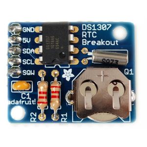

Step 2: Build Real Time Clock (RTC) Module Test & Connect to Arduino Nano
Build the RTC module per the Adafruit instructions, except omit the 5 pin male header as it's better for this project to just use short wires to directly connect the RTC to the Arduino Nano (see photos and wiring diagram).
https://learn.adafruit.com/ds1307-real-time-clock-...
Test the module using the Adafruit example code to ensure everything is working correctly - you can set the RTC current time and date and read back date values.

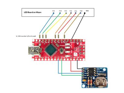

Step 3: Disassemble the Moon, Add Ardunio Nano, Program & Test
1) Remove and save the 2 sets of screws holding the 3 moon "disks" together. The middle finned disk has a strip on 6 LEDs, cut the LED wires at THE MAIN PRINTED CIRCUIT BOARD (PCB). Also cut the leads from the 4 AA batteries to the PCB, and remove the infrared sensor and the PCB itself.
2) Solder the LED wires and 150 ohm current limiting resistors to Arduino Nano as shown in the photo and wiring diagram. I sandwiched the resistors between two strips of foam tape to prevent them from shorting together.
3) Connect the Arduino to your computer via USB cable and prepare to upload the sketch MoonPhase2.ino. For your first test, making the following edit to the sketch:
1) Around line 65 adjust the if statement so the moon is "on" during the hours of the day when you're running your test, for example, if you're testing around 3:00 PM then... if (h < 14 || h >16)
4) Now upload the program - check that the correct LEDs are illuminated based on the actual phase of the moon for that date (date value from the RTC). To check what the actual moon phase should be, use the link below.
http://stardate.org/nightsky/moon
5) Unfortunately, depending on the day of the month, the current moon phase may be such that no LEDs should be illuminated. In that case you can either (1) take it on faith that no LEDs illuminated really means everything is working OK, (2) wait for a better day to test when some LEDs should be illuminated, or (3) manually adjust the RTC date to a fake date when the LEDs should be illuminated. To manually adjust the RTC, see the link below:
http://forum.arduino.cc/index.php?topic=128928.0
