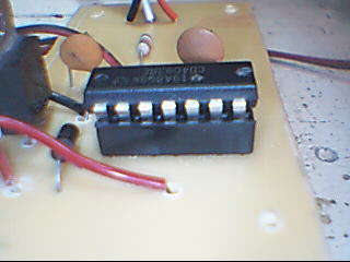

I could of just plugged the wall wart directly into the wall outlet then powered the circuit with a power jack but that means i would use 2 plugins. With taking the wall wart apart and using only the circuit i could make this all on one board and one plugin.
Step 4: Main Board
Arrange the components for best fit and clearance. Solder everything down and run traces as per the circuit diagram.
