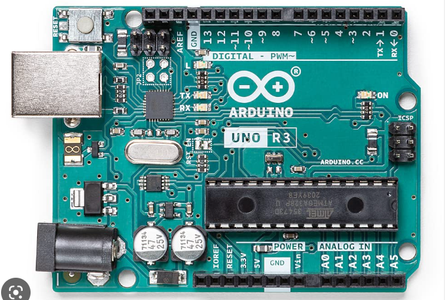

1 Arduino

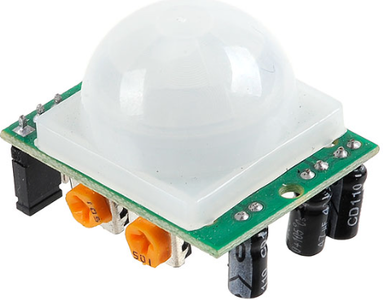

2 PIR Motion Sensors

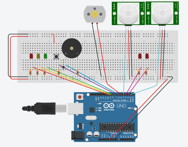

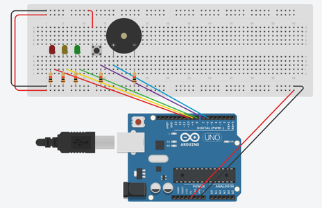

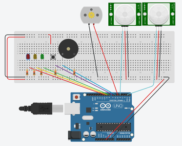

Step 2: Building- the Breadboard and the Arduino
Connect the positive column to the 5V pin on the Arduino with an M-M wire. This will power the system.
Connect the negative column to the GND pin on the Arduino with an M-M wire. This is the system's ground.
You also need to connect both sides of the Arduino with M-M wires so each side can be powered, positive to positive and negative to negative.
Step 3: Building- the First 3 LEDs
Take a red, yellow, and green LED and insert them into the breadboard in succession.
Place one end of a resistor into the rows below each LED's shorter side, ensuring that the other end is connected to the negative column.
Use 3 M-M wires and connect the longer side of the red, yellow, and green LEDs to the digital pins 10, 9, and 8 on the Arduino respectively.
Step 4: Building- the Pushbutton
Place the push button next to the 3 LEDs with each side of the pushbutton on a different side of the breadboard.
Take an M-M wire and connect the row where the upper left corner of the pushbutton sits to the positive column on that same side.
Then use another M-M wire to connect the row below the bottom right corner of the pushbutton to the digital pin 7.
In that same row put a resistor so that it connects to the negative column.
Step 5: Building- the Piezo Speaker
Connect the speaker's two terminals to the breadboard.
Connect the row of the negative terminal to the negative column with a resistor and use an M-M wire to connect the row of the positive terminal to digital pin 6.
Step 6: Building- the DC Motor
The DC Motor should already come with wires attached, so the negative or black wire connects to the negative column and the positive or red wire connects to digital pin 5.
Step 7: Building- the PIR Motion Sensors
Take the first PIR Motion Sensor and, using F-M wires, connect the positive terminal to the positive column, the negative terminal to the negative column, and the signal terminal to digital pin 4.
Take the second PIR Motion Sensor and use F-M wires to connect positive to positive, negative to negative, and signal to digital pin 1.
Step 8: Building- the Indicator Lights
Take the two remaining LEDs and add them to the breadboard. Under the shorter terminal of each LED, place a resistor in that same row, making sure to connect each to the negative column.
Use 2 M-M wires to connect the other terminal of the left and right LED to digital pins 3 and 2 respectively.

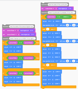

Then upload the code to your Arduino.
A picture of the block code is also included if you would rather copy that and build it yourself.
