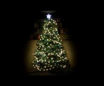

Step 5: Hang Lights, Determine Positions
Hang the lights on the tree, and we need to calculate each pixels X and Y location to embed into the code.
To do this use the attached version of the xmas.c code and uncomment the first section of the Arduino loop( ) which lights each segment of 10 lights. You'll want to extend this section if you have beyond 50 LEDs with a simple copy/paste. Also remember to alter the #define LED_COUNT as in the previous step to match your LED count
In the attached video I took the grid image and overlaid it on top of the tree lighting in a Video Editor to allow me to get each of the 200 positions. Be sure to try and get grid column 1 and row 1 overlaid such that the lower left most LED light is at position 1,1. This is done so that the Arduino program can easily determine the middle of the tree in both the X and Y directions.
Watching the video and entering in X,Y pairs into xmas.c is a manual process, and 200 lights sounds daunting, but surprisingly this didn't take much time to record all LEDs. I'd estimate at 15-20 minutes to derive (X,Y) positions for 200 lights.
In lieu of a Video Editor you could take the video with a cell phone and then draw or print your own grid on paper to physically place on the cell phone/tablet/computer monitor while you play back the video.
To help isolate the 10 pixel segment being walked over, and entire 10 light segment is first lit in the following pattern:
Green Light 10 pixel strand = +10
White Light 10 pixel strand = +1
Thus a Green Light Flash followed by 4 White Light Flashes would be = 10 + 4 = 14th set of 10
As you calculate values, place them in the Positions array in the Arduino code.
