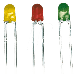

  2. buzzer(local shop)
  3. led(local shop)

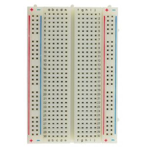

  5. bread board

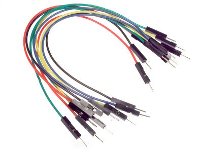

  6. jumper wire( male to male)

  2. connect the led so that they have a common ground keep a pin gap between two leds use 2 green, 2 yellow,4 red.

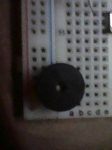

  3. connect the buzzer as shown

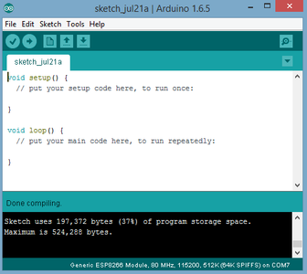

Step 4:
#define trig 12
#define echo 13
#define power_pin 11
#define buzzerReset A0
#define buzzer 10
int ledS[] = {2,3,4,5,6,7,8,A1};
