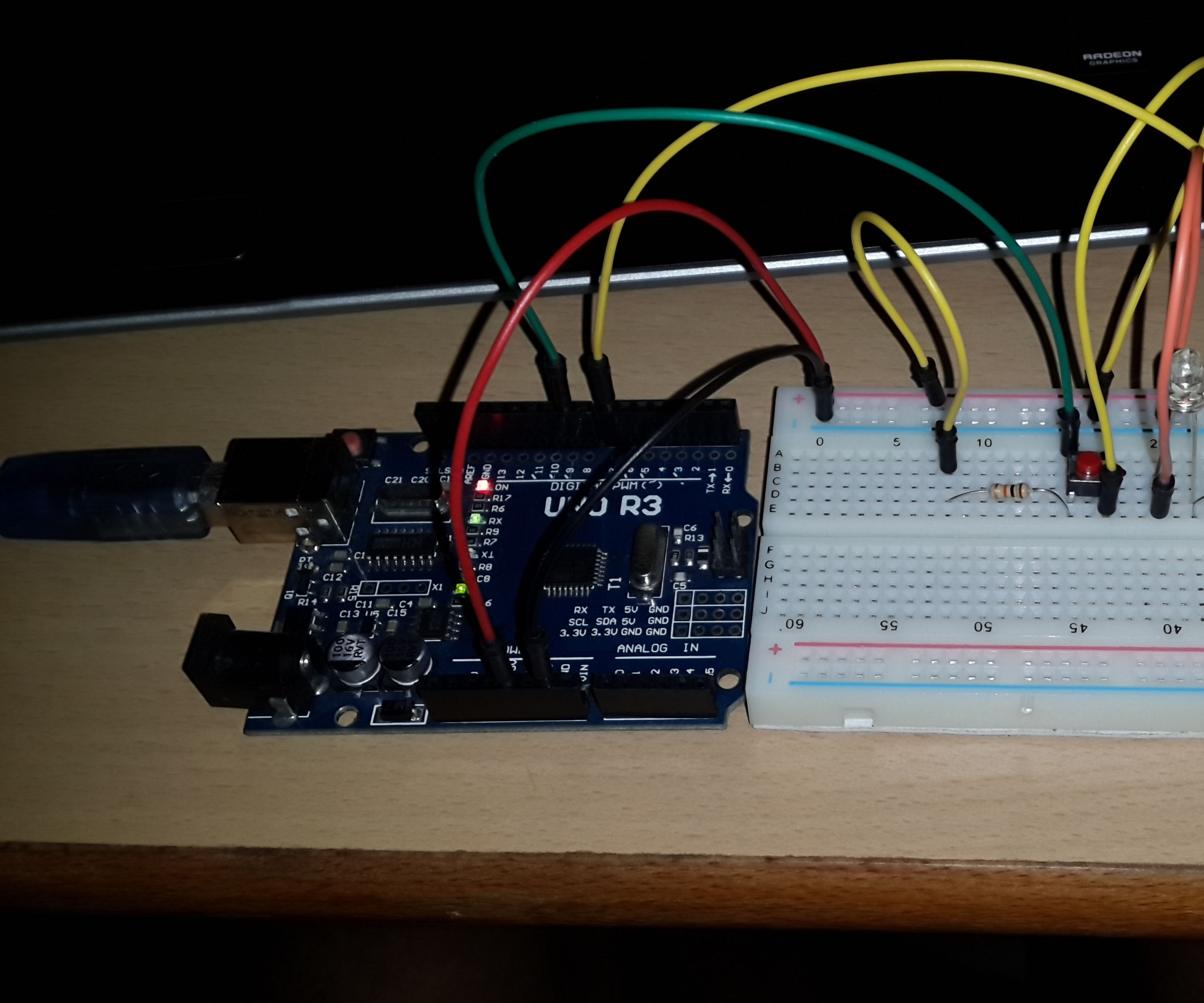

Step 2: Connections
Just five pins so connections should not be any trouble.
The module is provided with an option for cascading with more modules of its kind, thus forming a larger display. Lets consider only one module for simplicity to begin with.
Make connections as follows in accordance with the code
VCC- 5v of arduino
GND- gnd of arduino
Din- pin 12
CS(Load)-pin 10
Clk-pin 11
Dout is connected to the Din of the next module.
