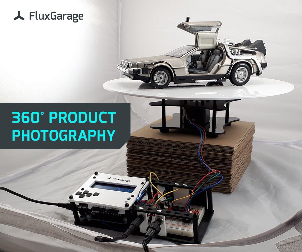

Introduction: Arduino Controller for Automated 360° Product Photography
Let's build an arduino based controller that controls a steppermotor and a camera shutter. Together with a steppermotor driven turntable, this is a powerful and low cost system for automated 360° product photography or photogrammetry.
The automatic camera shutter is based on a great library from „Sebastian Setz“ and works for infrared triggered cameras of Nikon, Canon, Minolta, Olympus, Pentax, Sony.
I've prepared two versions of the controller:
- A basic version that is operated with a simple pushbutton and a status led.
- An advanced version that uses a 16x2 LCD + keypad shield and thus has a menu to change the variables „on the fly“ and not only in the sourcecode.
What does the controller do?
If you trigger a „photoshooting“ by pushing the button, the turntable performs a full revolution, divided into a predefined amount of steps. After each rotation step, the controller makes a short break and then triggers the camera. You will be able to change the variables of the rotation speed, the delay time and the number of steps in the source code (for simple controller version) or in the display menu (advanced controller version).

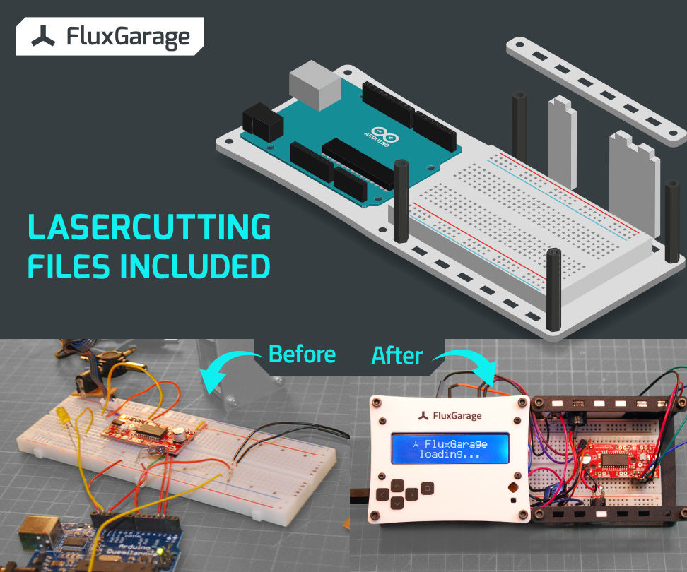

Step 2: Assemble Circuit
Solder Easydriver board for breadboard use:
In order to use the easydriver on a breadboard, you need to solder some male pin headers on the board. The best way is to put the male pin headers into the breadboard, lay the easydriver on top and then solder the pins.
Wiring up:
Wire up the parts as shown in the regarding Fritzing graphic for the basic or advanced controller. Download the Firtzing diagrams on github, find the links in step 1.
Double check if everything is connected as follows:
- Arduino digital pin 02 = dir pin of Easydriver
- Arduino digital pin 03 = step pin of Easydriver
- Arduino digital pin 09 = output for piezo
- Arduino digital pin 12 = output for infrared LED (place 220 ohms pre resistor before led)
+ for Basic Controller:
- Arduino digital pin 04 = input for pushbutton (place 10k ohms resistor before button ground)
- Arduino digital pin 13 = output for status LED (place 220 ohms pre resistor before led)
+ for Advanced Controller:
- Stack the display + keypad shield onto the arduino, actually those pins are used: Arduino analog pin A4+A5 and 5V+GND.

Step 5: Start Shooting
If you've built your own controller + turntable and your camera is in place, you're all set to start shooting ... almost. Let me share some learnings from my own experiments:
- Use a light tent to illuminate your objects evenly. You can find lots of good tutorials here at instructables.com that show how to create a diy lightbox. Also, there are inexpensive textile light tents that can be bought in many online shops.
- Use lightbulbs with the same color temperature (Kelvin)
- Focus the object on the turntable manually, deactivate your camera's autofocus
- Turn off your camera's image stabilizer, if working with a tripod
- Select a measuring range in the background, where the shot object won't appear. By doing so, you'll avoid flickering in your image sequence. Another way is to manually set your camera's exposure times etc.
