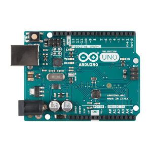

  • Arduino UNO (or any other board)

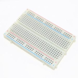

  • Breadboard

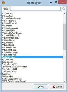

Start Visuino as shown in the first picture Click on the "Tools" button on the Arduino component (Picture 1) in Visuino When the dialog appears, select "Arduino UNO" as shown on Picture 2

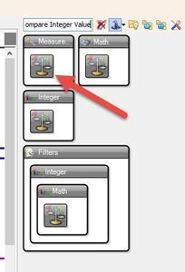

Step 4: In Visuino Add Components
  • Add "TM1637 7 Segment Display 4 Digits Module + 2 Vertical Points (CATALEX)" component
  • Add "Up/Down Counter" componentAdd "Pulse generator" component
  • Add "Divide Integer By Value" component

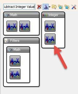

  • Add "Multiply Integer By Value" componentAdd "Subtract Integer Value" component
  • Add "Counter" componentAdd "Toggle(T) Flip-Flop" component

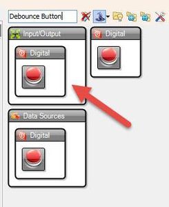

  • Add 2X "Debounce button" componentsAdd "Compare Integer Value" component

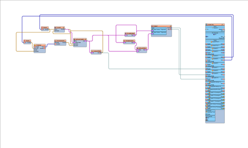

Step 6: In Visuino Connect Components

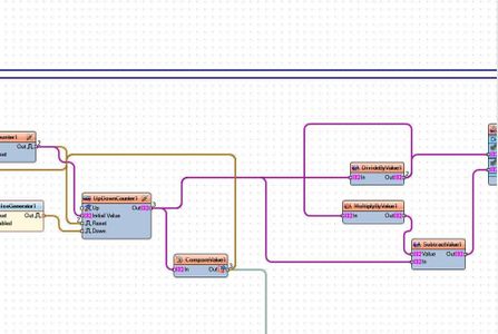

  • Connect "PulseGenerator1" pin Out to "UpDownCounter1" pin Down
  • Connect "UpDownCounter1" pin Out to "DivideByValue1" pin In and "SubtractValue1" pin In

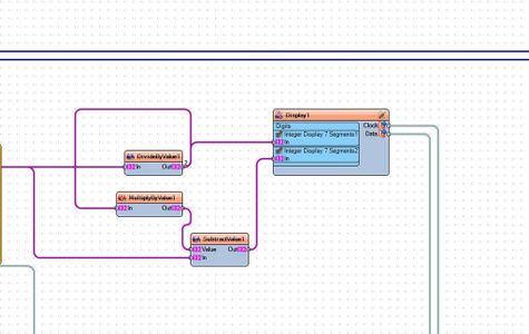

  • Connect "DivideByValue1" pin Out to "MultiplyByValue1" pin In and "Display1" > "Integer Display 7 Segments1" pin In
  • Connect "MultiplyByValue1" pin Out to "SubtractValue1" pin Value
  • Connect "SubtractValue1' pin Out to "Display1" > "Integer Display 7 Segments2" pin In

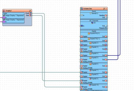

  • Connect "Display1" pin Clock to Arduino digital pin 10
  • Connect "Display1" pin Data to Arduino digital pin 9

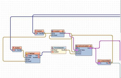

  • Connect Arduino digital Out pin [4] to "Button1" pin [In]
  • Connect Arduino digital Out pin [5] to "Button2" pin [In]
  • Connect "Button1" pin[Out] to "Counter1"pin [In] and to "TFlipFlop1" pin[Reset]
  • Connect "Button2" pin[Out] to "TFlipFlop1" pin[Clock]
  • Connect "TFlipFlop1" pin[Out] to "PulseGenerator1" pin[Enabled]
  • Connect "Counter1" pin[Out] to "UpDownCounter1" first to pin[Reset] and then also to pin[Initial Value]
  • Connect "UpDownCounter1" to "CompareValue1" pin[In]
  • Connect "CompareValue1" pin[Out] to "Arduino" digital pin[7] , this pin will be used to turn the Relay On
  • Connect "CompareValue1" pin[Out] first to "Counter1" pin[Reset] and also to "UpDownCounter1" pin[Reset]

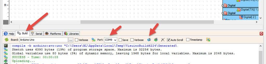

Step 7: Generate, Compile, and Upload the Arduino Code
In Visuino, at the bottom click on the "Build" Tab, make sure the correct port is selected, then click on the "Compile/Build and Upload" button.
