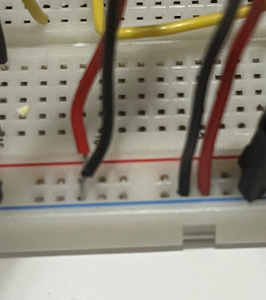

Step 1: Basic Setup
First, before we start building our components let's make it so that we have all the things ready and organized, after we have done that we will set up basic supplies such as connecting the Arduino Ground(GND) and Power(5V) to the breadboard ground and power port.
For now, let's keep the power port unplugged as we don't want to be shocked or make our circuit spark up while we are building our crane.

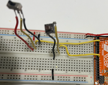

Step 2: Slide Switch (On/Off) and Killer Switch
Slide Switch
This slide switch will act as an ON/Off switch for the whole Arduino circuit, and the connections are;
  • The middle pin will connect to Pin 3.
  • Any of the other sides can be connected to power(PWR) and ground(GND).
Killer Switch
Since we need a button to be pressed so that the whole crane stops functioning we will be using a pushbutton that will work as a killer switch, the wiring for the following project would be as follows;
  • One leg of the button will be connected to the GND
  • Opposite of that leg of the button will be connected to Pin 9 on the Arduino
10k Ohm resistor if necessary will be connected between the button leg connected to the digital pin and 5V (pull-up configuration) or GND (if using a pull-down configuration).
Just in case you don't have an idea of what a pull-up or pull-down configuration refers to, it's basically a method of connecting a resistor to ensure a known voltage level at a digital input pin when no active signal is present. These configurations prevent floating inputs, which can cause unpredictable behaviour in digital circuits.

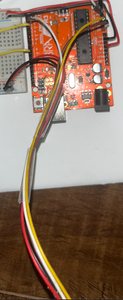

Step 4: Set Up the Joystick
As we can now begin setting our actual parts, let's begin by configuring the joystick. The 5-pin joystick I'll be using has the following pin locations: X, Y, Bt, VCC, and GND. To make it easier for you all, I will be pinning it in this manner:
  • VCC(Red Wire): to 5V on the Arduino
  • GND(Black Wire): to GND on the Arduino
  • X(Brown Wire): to A0 on the Arduino
  • Y(Yellow Wire): to A1 on the Arduino
  • Bt(White Wire): to Pin 2 on the Arduino
Step 5: Setup Both the Servo Motors
The 2 servo motors we are provided have wires brown, orange and red which isn't that hard to wire as it is a bit straightforward with the colours the wires have:
Red Wire on both the servo connects to Power(5V) on the Arduino
Brown Wire on both the servo connects to the ground(GND) on the Arduino
Servo 1 orange pin to Pin 10 on the Arduino
Servo 2 orange pin to Pin 11 on the Arduino

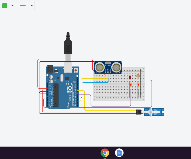

Step 6: Setup the 555 Timer Circuit
The 555 timers we will be using won't be required to work on code, so as it on manual we will just wire it, just so you have an idea, we will be using them as emergency lights, which is to let any workers below to press a button that will turn off the whole crane
The components we will need are:-
  • 555 timer
  • Jumper Cable
  • Capacitor
  • x3 Resistors
  • LED
  • SlideSwitch
Copy the wiring in the tinkercad image
