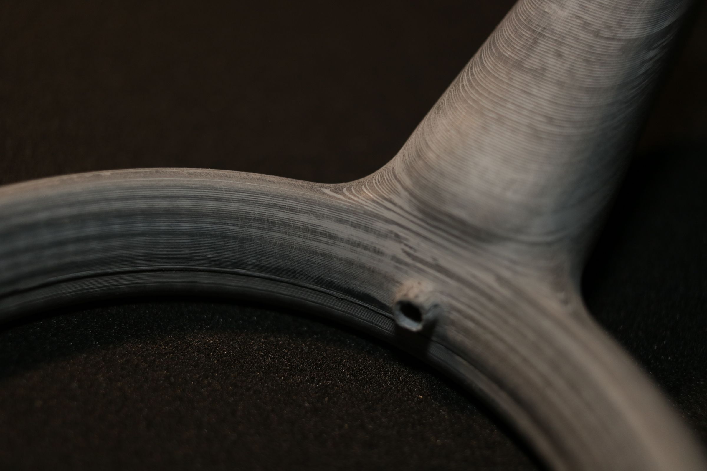

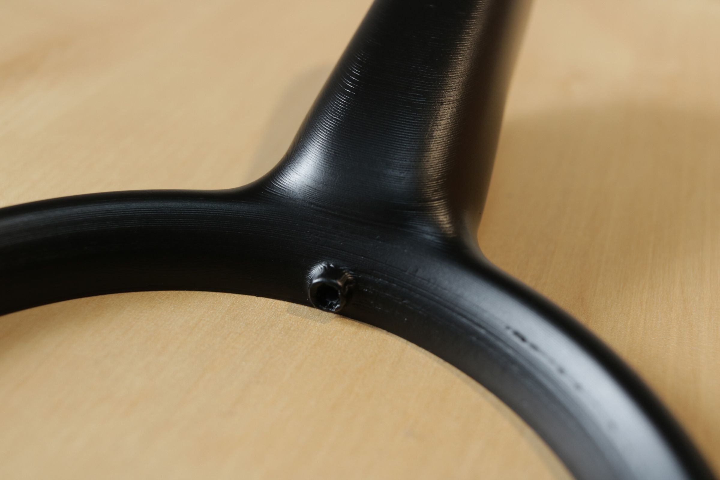

For this project I wanted to try a finishing technique for 3D printing.
here is what the 3D print looks like ...
I first sanded the pieces with 120 to 800 grit sandpaper
I applied a primer coat
I sanded it again with 800 grit sandpaper
Then I added 3 coats of black spray paint
here you have the "before and after" comparaison :
