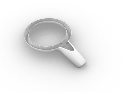

Step 3: Making Cover Part: 3D Printing
The body cover part has been designed in Rhino 7, it is composed of 3 parts.I printed the parts using PLA filament on Cura, and 3D printed on Multimaker2.
I took inspiration from SimonRob Instructables for the bottom piece. For the upper part, I designed a half ring cover piece so that the light does not catch the eye.
You can download all parts for 3d printing. Those with gcode are ready for direct 3d.
