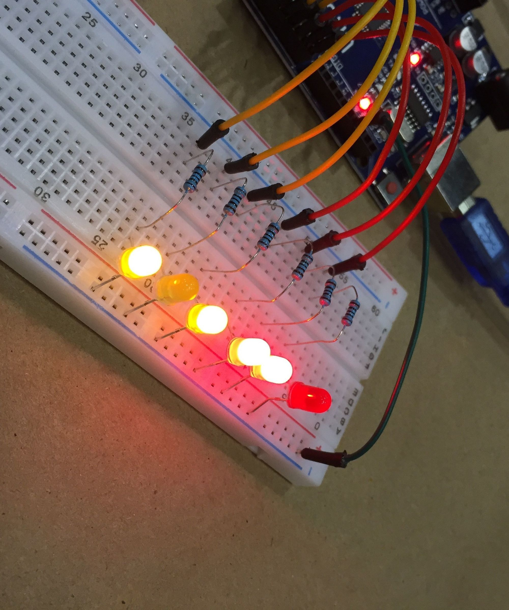

Step 1: Wiring Up Your Breadboard and Accessories
Wire up your breadboard as shown, connecting the Arduino with all the LEDs through the port expander (NOTE: in the first photo, the chip labelled "Microcontroller" represents the MCP23017 port expander). Additionally, connect the Arduino to the LCD screen. Ensure the contrast of the screen is properly adjusted by using the potentiometer on the back of the unit.
