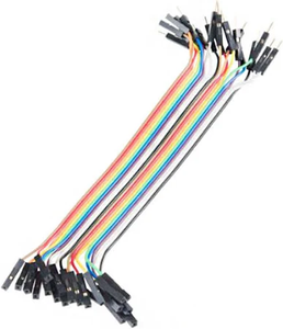

1. Connecting the Potentiometer
- Use the yellow jumper wire to connect the output of the potentiometer to A0 of Arduino.
- Next use the black jumper wire to connect the Ground of potentiometer to the negative rail of the breadboard (The black line).
- After that use the red jumper wire to connect the VCC of the potentiometer to the positive rail of the breadboard (The red line).

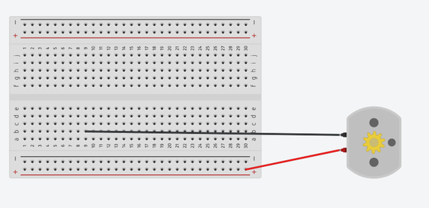

2. Connecting the DC motor
- Use the black jumper wire to connect the negative part of the DC motor which is known as (Terminal 1) to the breadboard, specifically at "b)9".
- Next use the Red jumper wire to connect the positive part of the DC motor which is known as (Terminal 2) to the positive rail of the breadboard (The red line).

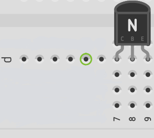

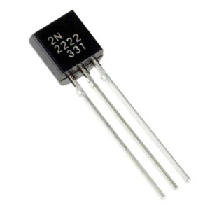

3. Connecting the NPN transistor
- The NPN transistor should align to connect D)7,8,9. Put the NPN transistor in the order of Collector, Base and Emitter. The Collector for example should connect specifically at "d)7", The Base should connect specifically at "d)8" and The Emitter should connect specifically at "d)9".

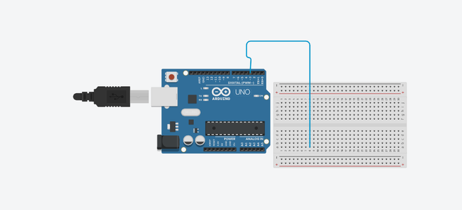

6. Wiring
- Connect a long blue jumper wire at the breadboard specifically at "a)11" to the Arduino Board "~11" pin in the Digital PWM rail section.
- Connect another long blue jumper wire at the breadboard specifically at "a)8" to the Arduino Board "~3" pin in the Digital PWM rail section.
- Connect a red jumper wire at the positive rail of the breadboard specifically at the second dot or pin to the Arduino Board specifically at the "5V" pin in the (Power rail section).
- Connect a black jumper wire at the negative rail of the breadboard specifically at the first dot or pin to the Arduino Board specifically at the "GND" pin in the (Power rail section).
- Connect the small groups black jumper wires exactly as shown in the "8th image".
