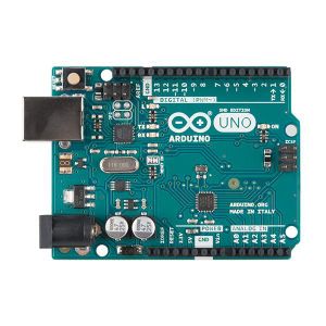

  • Arduino UNO (or any other board)

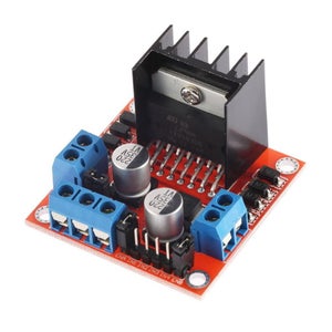

  • L298N DC MOTOR CONTROLER Driver

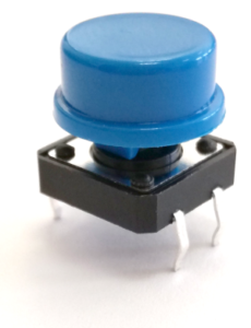

  • Button
  • 1K ohm resistor for the button

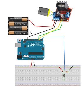

Step 3: The Circuit
  • Connect Power supply (batteries) pin (gnd) to motor driver controler pin (gnd)
  • Connect Power supply (batteries) pin (+) to motor driver controler pin (+)
  • Connect Power supply (batteries) pin (+) to Arduino pin (VIN)
  • Connect GND from Arduino to motor driver controler pin (gnd)
  • Connect digital pin(3) from Arduino to motor driver pin (IN1)
  • Connect digital pin(4) from Arduino to motor driver pin (IN2)
  • Connect DC motor to the motor driver as you can see on the schematic
  • Connect Arduino pin [5V] to breadboard positive pin [Red line]
  • Connect Arduino pin [GND] to breadboard negative pin [Black line]
  • Connect Arduino Digital pin [2] to the Resistor and button
  • Connect other side of the resistor to the breadboard pin [GND]
  • Connect Other pin of the button to the breadboard positive pin [5V]

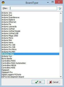

Step 4: Start Visuino, and Select the Arduino UNO Board Type

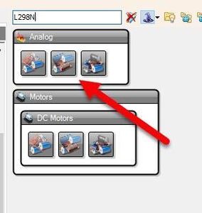

Start Visuino as shown in the first picture Click on the "Tools" button on the Arduino component (Picture 1) in Visuino When the dialog appears, select "Arduino UNO" as shown on Picture 2

  • Add "L298N" component

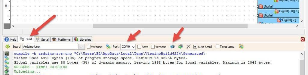

Step 8: Generate, Compile, and Upload the Arduino Code
In Visuino, at the bottom click on the "Build" Tab, make sure the correct port is selected, then click on the "Compile/Build and Upload" button.
