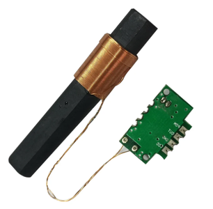

  • DCF77 Module link

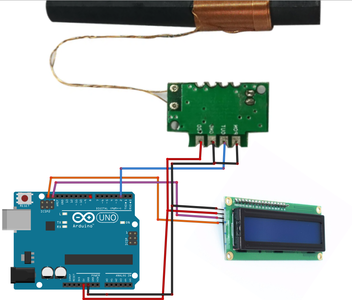

Step 2: The Circuit
  • Connect LCD Display pin [SCL] to Arduino pin [SCL]
  • Connect LCD Display pin [SDA] to Arduino pin [SDA]
  • Connect LCD Display pin [VCC] to the Arduino positive pin [5V]
  • Connect LCD Display pin [GND] to the Arduino pin [GND]
  • Connect Arduino Digital pin [2] to the DCF77 pin [Out]
  • Connect Arduino pin [5V] to the DCF77 pin [VCC]
  • Connect Arduino pin [GND] to the DCF77 pin [GND]
  • Connect Arduino pin [GND] to the DCF77 pin [PON]
Note: Pin PON must be connected to Logic False to be Enabled, you can also control it using the Arduino Digital pin

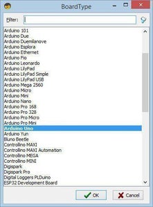

Step 3: Start Visuino, and Select the Arduino UNO Board Type
Start Visuino as shown in the first picture Click on the "Tools" button on the Arduino component (Picture 1) in Visuino When the dialog appears, select "Arduino UNO" as shown on Picture 2

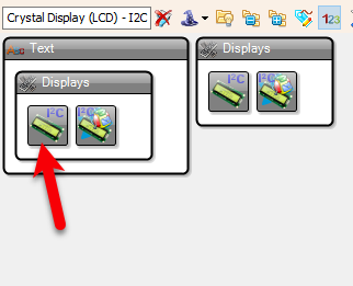

  • Add "Liquid Crystal Display (LCD) - I2C" component

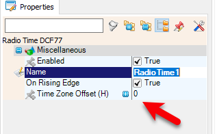

  • You can set your time zone by selecting "RadioTime1" and in the properties window set "Time Zone Offset (H)"

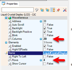

  • If you are going to use the LCD I2C then select "LiquidCrystalDisplay1" and in the properties window set "Columns" to 20 and "Rows" to 4, Columns and Rows depends on the type of your Display some only have 16 columns and 2 Rows, then double click on the "LiquidCrystalDisplay1" and in the "Elements" window drag "Text Field" to the Left side and in the properties window set "Width" to 20 and "Initial Value" to Date & Time
  • In the "Elements" window drag another "Text Field" to the Left side and in the properties window set "Width" to 20 and "Row" to 1

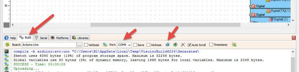

Step 7: Generate, Compile, and Upload the Arduino Code
In Visuino, at the bottom click on the "Build" Tab, make sure the correct port is selected, then click on the "Compile/Build and Upload" button.
