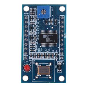

  • Connect "AD9850" module pin Serial "W_CLK" to Arduino Digital pin 8
  • Connect "AD9850" module pin Serial "FQ_UD" to Arduino Digital pin 9
  • Connect "AD9850" module pin Serial "Serial Data" to Arduino Digital pin 11
  • Connect "AD9850" module pin Serial "Reset" to Arduino Digital pin 10
  • Connect "AD9850" module pin VCC to Arduino pin 5V
  • Connect "AD9850" module pin GND (On both sides) to Arduino pin GND

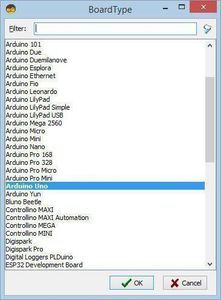

Start Visuino as shown in the first picture Click on the "Tools" button on the Arduino component (Picture 1) in Visuino When the dialog appears, select "Arduino UNO" as shown on Picture 2

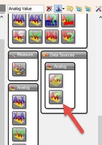

  • Add "Clock Generator" component
  • Add "Counter" component
  • Add "Analog Value" component
  • Add "Integer To Analog" component

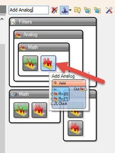

  • Add "Add Analog" component
  • Add "Analog Multi Source" component

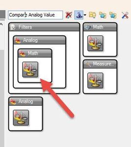

  • Add "Compare Analog Value" component
  • Add "Analog On/Off Switch" component
  • Add "OLED I2C" component
  • Add "Analog Devices Serial DDS Synthesizer (Signal Generator) - AD9850" component

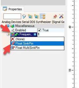

  • Select "Synthesizer1" and in the properties window select "Frequency" and click on the Pin Icon and select "Float SinkPin"

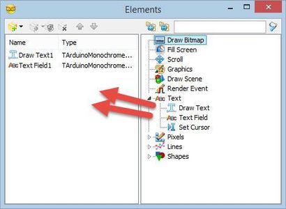

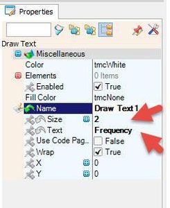

  • Double click on the "DisplayOLED1" and in the "Elements" window drag "Draw Text" to the left side and in the Properties window set "Text" to "Frequency" and "Size" to 2

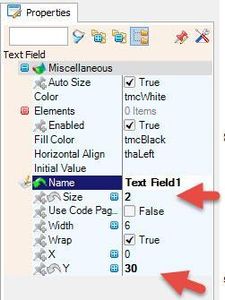

  • In the "Elements" window drag "Text Field" to the left side and in the Properties window set "Size" to 2 and "Y" to 30
  • Close the "Elements" window

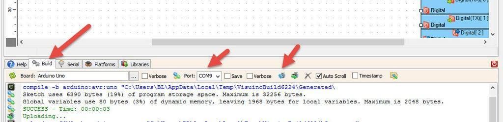

In Visuino, at the bottom click on the "Build" Tab, make sure the correct port is selected, then click on the "Compile/Build and Upload" button.
