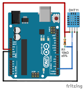

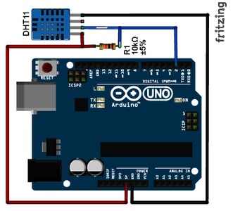

Step 1: ​Schematic:
Here’s how to connect the DHT11 to Arduino.

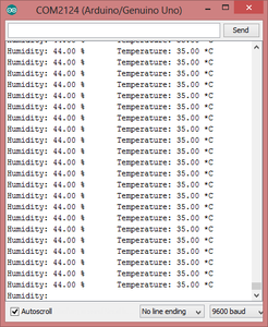

You should see the humidity and temperature on the serial monitor once the sketch has been successfully uploaded to Arduino.
Step 3: ​Demonstration:
