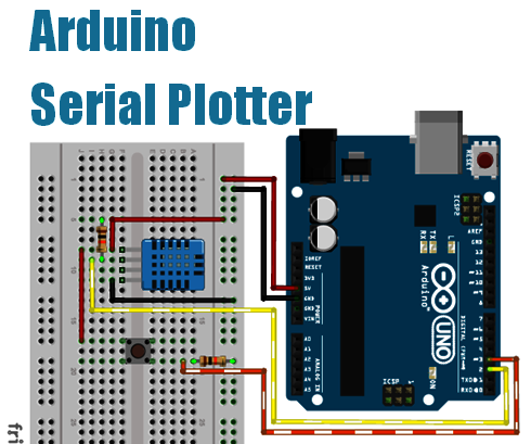

Step 1: Schematic:
Here’s how to connect the components to the Arduino module.
