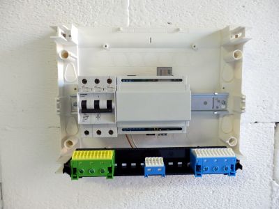

Step 8: Install It!
Put your ArduiBox into a control cabinet
