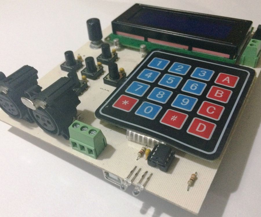

Control tool for testing and light show by the DMX-512 protocol, ideal for quick tests on fixed or temporary installations of lighting. This project arises from the need to have a portable system for rapid testing in lighting installations, without the need to install lighting consoles, interfaces or computers in environments outside, hostile or difficult to access.

Step 6: Preparing the Phenolic Plate
We use a phenolic plate one face time, we reinforce the copper sandpaper water, thinner circularly
Step 7: Negative PCB
With Proteus send files to print a pre-press acetate negative (there is a PDF with the file)
Step 8:
Use and method photosensitive film
We use a paper laminator film to adhere perfectly pcb
Step 9: UV Light
Add a little water between the plate and acetate so that it does not move and apply UV light
Step 10: Revealed
Apply the ferric chloride are clean and ready
Step 11: We Perforate Plates
Step 12: Soldered Components
Step 13: Stripped to the Potentiometer Guide
phenolic drilled plate to put the potentiometer
Step 14: Keyboard Base
In the case of the girl plate, putting them headers weld the top, above the pins cut with sandpaper and water removed the excess
Step 15: Keyboard Mount
We add tape double tape para pegar el teclado a la placa
Here we encounter a detail, headers clogged with the flex of the keyboard, the cut (we consider for the next version)
Weld the headers that are under the keyboard and bend backward to connect the keyboard laterally
We put in place the keyboard on the LCD board, here's a detail, the base of the MAX485 am very attached to the keyboard, we force a little (we consider in the next version)
Step 16: Mount the Arduino
We add to Arduino Mega some tape to the USB port to prevent a short circuit between tracks
