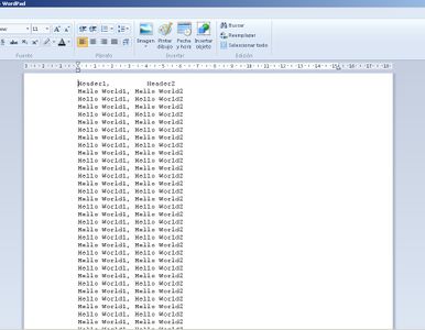

Step 3: Testing SD Card
Now we are ready to write a simple "Hello World" on the sd card.This sketch is very simple (no serial monitor).
1.-Make sure that you have the libraries needed :SD, SPI, WIRE
2.-Remember to change your chipSelect
const int chipSelect = 8; //Maybe not yours!!.You have to put your cs pin here
3.-Uncomment this line if you need.
//pinMode(10 , OUTPUT); // Uncomment if necesary.I did not need
4.- You can change "Datos" but you will have to change the lines that content this word.
Example:
File myData;
myData=SD.open...........
myData.println...............
myData.close.........
This sketch writes 2 headers in the void setup just once . Then hello world1 and hello world2 every second (void loop) on your sd card. Give it a minute and then check your sd card. Now check the file in your computer and you will have something like in the picture.
The most common problems are: the pin 10 of the arduino as output or not , wrong chipSelect or bad sd card.

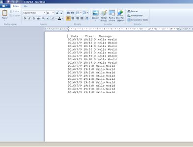

Step 5: SD and RTC Together
Now we´ll write "Hello World"to de sd card with time stamp.I have mixed the two sketch and changed the sd card instead the serial monitor.
Consider the same precautions of the previous steps.
If everything works fine , you will have the same information like in the picture.You can try with others sample rates
This is structure to print:
void loop(){
DateTime now = RTC.now(); //Clock call
-The sampling rate we want
if(now.second()==0){ //Sample every minute
-Reopen the file (first open was for headers )
Logfile=SD.open("Logfile.csv",FILE_WRITE); //Will open and will write date and message
-The date and time. You can change the order
now =RTC.now();
Logfile.print(now.year(), DEC); //Print date and time(not saved yet)
Logfile.print("/");
Logfile.print(now.month(), DEC);
Logfile.print("/");
Logfile.print(now.day(), DEC);
Logfile.print(" ");
Logfile.print(now.hour(), DEC);
Logfile.print(":");
Logfile.print(now.minute(), DEC);
Logfile.print(":");
Logfile.print(now.second(), DEC);
-We print the message or values
Logfile.print(" Hello World"); //Print message(not saved yet)
Logfile.println(); //Jump to the next line
Logfile.close(); //Print saved
delay(1000); //One data per second

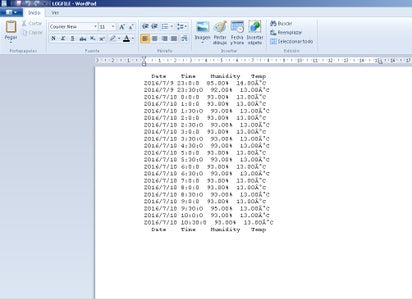

Step 6: Working With a Sensor
If you want, You can make this temperature datalogger:
Arduino Data Logger With 2 DS18B20 and Sample Rate Control
https://www.instructables.com/id/Arduino-Data-Logger-With-2-DS18B20-and-Sample-Rate/

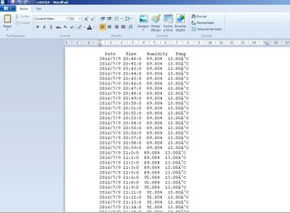

Now we add the code for the sensor. I am using the DHT 11 sensor module (with the circuit ready). If not ,follow the instructions of the DHT library. This is not a fast sensor and sometimes you don´t get data . It´s just to show you how it works.
We take the code of the last step and add the lines we need. You can take this example and add other sensor.
I´m using the pin 2 of the arduino to conect with the sensor data ,Vcc to 5V and GND to GND.
We also have to change the prints.
Logfile.println(" Date Time Humidity Temp"); //Print headers (not saved yet)
Logfile.print(h); //Print humidity(not saved yet)
Logfile.print("%"); //Print simbol
Logfile.print(" "); //Space between data
Logfile.print(t); //Print temperature
Logfile.print("°C"); //Print simbol
You can use the sample rate of the above steps. You can polish the codes according to your needs.
