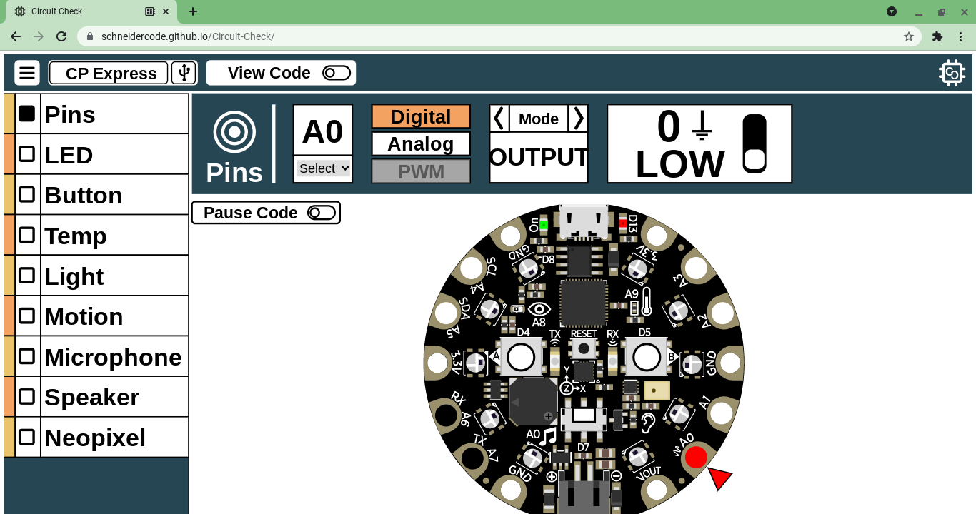

Step 2: Example Program
An example program can found under "File > Examples > ArduinoDebugger > 1_Basic_Setup". The code for the example sketch is also provided at the bottom of this step. Upload the example program to your chosen Arduino microcontroller and then open up the Arduino IDE's Serial Monitor.
Via the Serial Monitor, you'll be able to access the breakpoint's menu which will give you control of the program's variables (counter, message) and the board's hardware pins. Try updating a variables value or changing a hardware pin's state (for example Digital Pin 13 is often an onboard LED; try setting it to HIGH/LOW).
