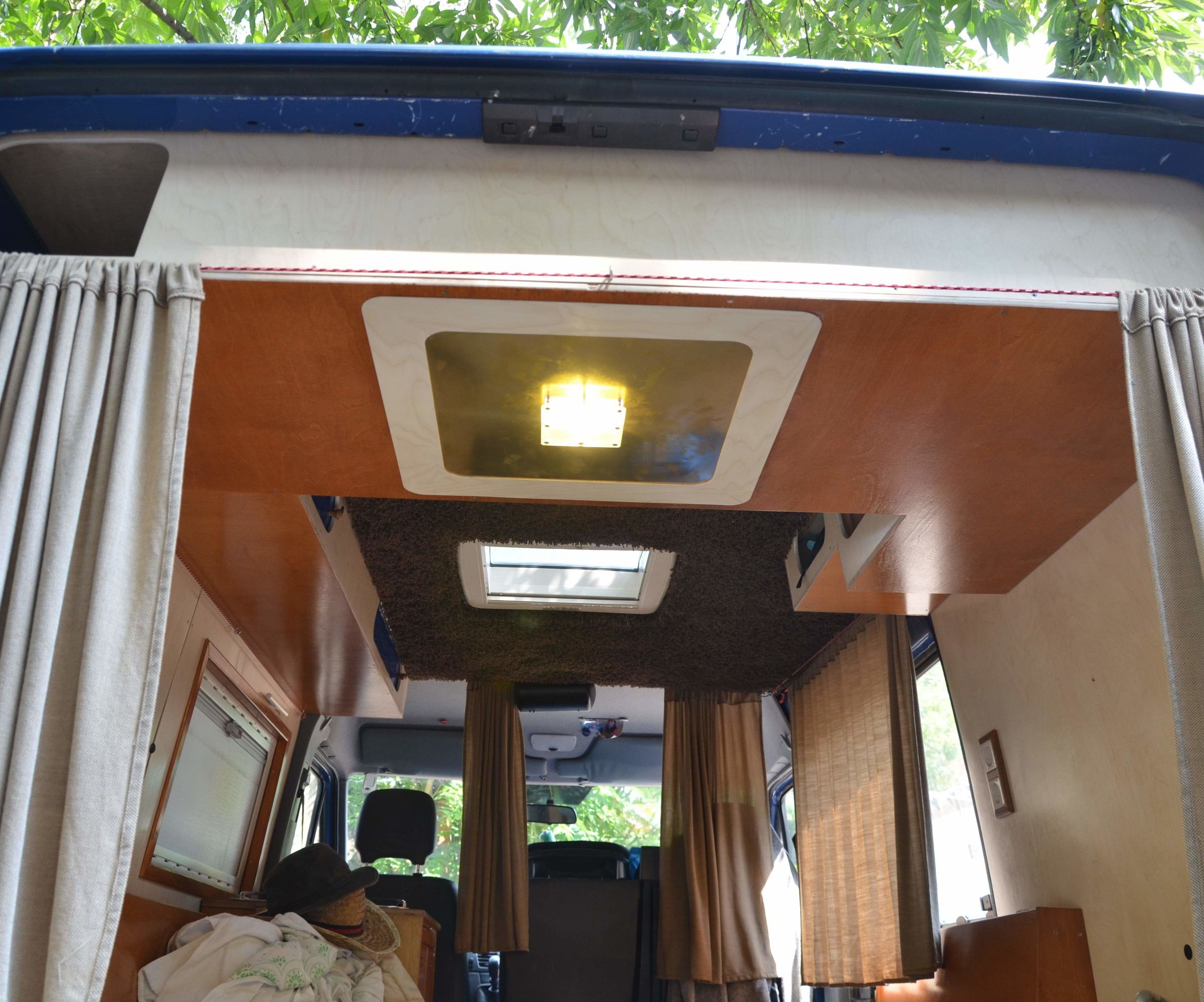

The device is a PWM modulator for a 30W light in my car. Since it uses up to 30 watts when powered on, I do not care about power consumption while the device is operating.

In my case it is a PWM modulator for an LED lamp.
