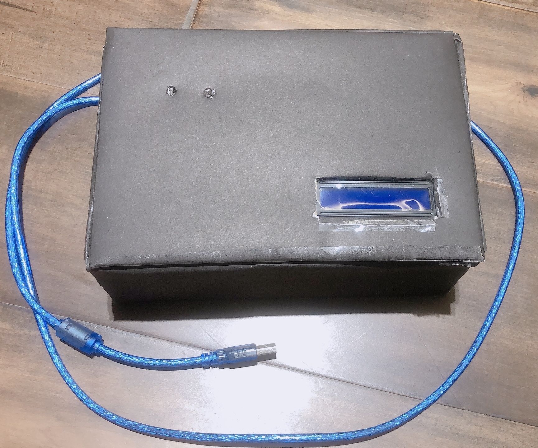

Step 4: Make Your Cover
Forth, use your imagination and creativity to create a cover of your machine. You can use any material you want if you want to make a special and creative one. If not, here is a sample of how I cover my machine. I use cardboard and paper to wrap up my machine. And then I make a paper dice and attach it to my machine for decoration.
Step 5: Pull Your LEDs Out
Next, after you finish making your cover, remember to pull out your LEDs, so your Arduino machine can still work even if you need the breadboard and most of the wires under the cover. You may need some extra wires or crocodile clips to keep the LEDs connected to the breadboard. Only stick the seven LEDs out the cover to make the machine looks better.
