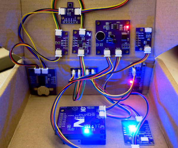

Step 3:
Daisy chain the modules together as shown on the Schematics diagram above.
Step 4:
Connect the Keypad using Male to Female Jumpers, to your Zuino M Uno
Step 5:
