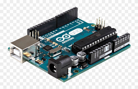

  • Arduino UNO (or any other Arduino)

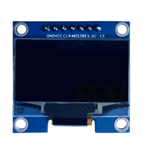

  • MPU9250 (is an accelerometer, gyroscope, magnetometer sensor)
  • OLED I2C Display

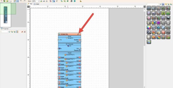

Start Visuino as shown in the first picture Click on the "Tools" button on the Arduino component (Picture 1) in Visuino When the dialog appears, select "Arduino UNO" as shown on Picture 2

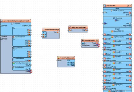

  • Add "Accelerometer Gyroscope Compass MPU9250 I2C" component
  • Add "OLED I2C" component
  • Add "Compass Heading" component

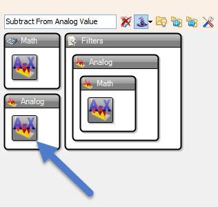

  • Add "Subtract From Analog Value" component

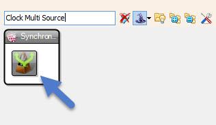

  • Add "Clock Multi Source" component

  • Select "SubtractFromValue1" and in the Properties window set the Value to 360
  • Select "ClockMultiSource1" and in the Properties window set Output Pins to 9

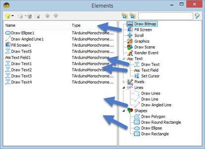

  • Double click on the "DisplayOLED1" and in the Elements window:
  • Drag "Draw Ellipse" to the Left side and in the properties window set "Height" to 58 and "Width" to 62
  • Drag "Draw Angled Line" to the left side and in the properties window set "X" to 30 and "Y " to 30
    Click on the "Angle" Pin Icon and select "Float SinkPin"
  • Add "Fill Screen" to the left side

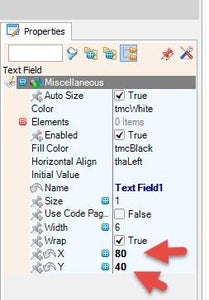

  • Add "Text Field" to the left side and in the properties window set "X" to 80 and "Y " to 40
  • Add 5X "Draw Text" to the left side
    • Select "Draw Text1" and in the Properties window set "Text" to N set "X" to 50 and "Y " to 28
    • Select "Draw Text4" and in the Properties window set "Text" to E set "X" to 30 and "Y " to 50
    • Select "Draw Text5" and in the Properties window set "Text" to Degreeset "X" to 80 and "Y " to 20
    • Select "Draw Text3" and in the Properties window set "Text" to S set "X" to 5 and "Y " to 28
    • Select "Draw Text2" and in the Properties window set "Text" to W set "X" to 30 and "Y " to 5

Step 6: In Visuino Connect Components

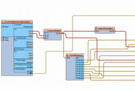

  • Connect "AccelerometerGyroscopeCompass1" Compass Pin [X] and Pin [Y] to "CompassHeading1" Pin [X] and Pin [Y]
  • Connect "CompassHeading1" Pin [Out] to "ClockMultiSource1" Pin [In]
  • Connect "CompassHeading1" to "SubtractFromValue1" Pin [In], and to "DisplayOLED1" > Text Field1 Pin [In]
  • Connect "SubtractFromValue1" Pin [Out] to "DisplayOLED1" > Draw Angled Line1 Pin [Angle]
  • Connect "ClockMultiSource1" Pin [0] to "DisplayOLED1" Fill Screen1 Pin [Clock]
  • Connect "ClockMultiSource1" Pin [1] to "DisplayOLED1" Draw Ellipse1 Pin [Clock]
  • Connect "ClockMultiSource1" Pin [2] to "DisplayOLED1" Draw Angled Line1 Pin [Clock]
  • Connect "ClockMultiSource1" Pin [3] to "DisplayOLED1" Draw Text1 Pin [Clock]
  • Connect "ClockMultiSource1" Pin [4] to "DisplayOLED1" Draw Text2 Pin [Clock]
  • Connect "ClockMultiSource1" Pin [5] to "DisplayOLED1" Draw Text3 Pin [Clock]
  • Connect "ClockMultiSource1" Pin [6] to "DisplayOLED1" Draw Text4 Pin [Clock]
  • Connect "ClockMultiSource1" Pin [7] to "DisplayOLED1" Draw Text5 Pin [Clock]
  • Connect "ClockMultiSource1" Pin [8] to "DisplayOLED1" Text Field1 Pin [Clock]
  • Connect "AccelerometerGyroscopeCompass1" Pin I2C [Out] to Arduino board pin I2C [In]
  • Connect "DisplayOLED1 " Pin I2C [Out] to Arduino board pin I2C [In]

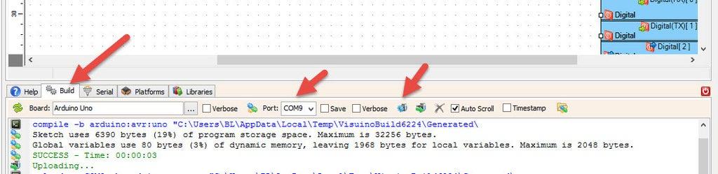

Step 7: Generate, Compile, and Upload the Arduino Code
In Visuino, at the bottom click on the "Build" Tab, make sure the correct port is selected, then click on the "Compile/Build and Upload" button.
