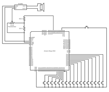

Step 2: Solder Potentiometer and Voltage Divider
The potentiometer and voltage divider should be soldered according to the schematic. For the 660 Ohm resistor, I used two 330 Ohm resistors in series. I used a small soldering board to assist in soldering the resistors and wires together. In the picture, it is a green board that has been repurposed from an earlier project, and so it has some irrelevant components included. The relevant resistors and wires are towards the top of the board in the picture.

This is the most solder-intensive step. You must solder all 18 buttons to the solderable breadboard. Consult the picture for where you should place the buttons on the board. All buttons are using the built-in input pullup of the Mega, so each will have its own digital pin while the other terminal will be connected to ground. On my breadboard, I routed all buttons to one of the Mega's digital grounds using a DuPont connector. Check the circuit schematic to be sure the buttons are wired properly.
Step 4: Connect Wiring to the Mega
Consult the above circuit diagram for proper wiring to the Mega 2560.
